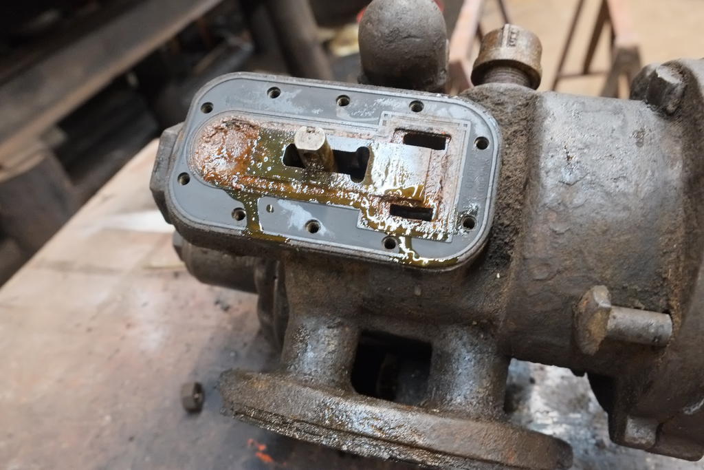

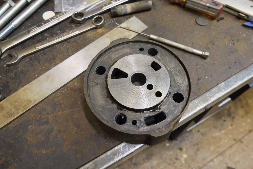

This is what one looked like before starting. Here is another unit, with a very odd pattern on the rotary valve seat:
It almost looks like someone in the past took a hand scraper to the thing!
As is typical with valves that saw very little / very poor maintenance near the end of service, the rotary valve and seat were very worn. Over time and especially with bad lubrication and dirt in the system, valves tend to grind themselves into a concave/convex pattern. In my experience, the brass rotary valve is always convex because it has the greater range of motion. The two surfaces may actually be very conformal and might even have acceptable leakage. That was not the case here! This valve had audible leakage out the exhaust pipe (which runs down through the floor of the car).
I put a straightedge across the surface and it was "out" by at least 6 thou. That's really too much to take by lapping so I had to resort to cruder methods:

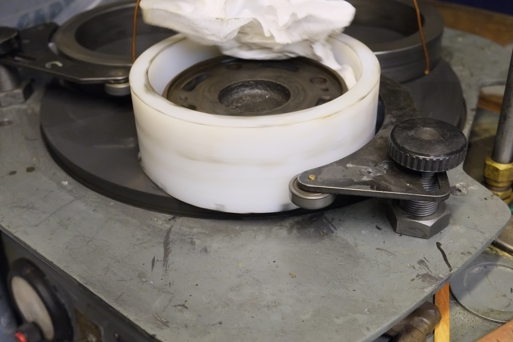

The rotary valve casting is not normally machined on the outside. It is just the rough casting including the two "lugs". So that's very hard to get to run true in the lathe chuck. I made a quick fixture out of a cut off piece of steel disc stock, turned to fit inside the diameter of the bottom part of the casting and faced on both sides, then drill/tapped to line up with two of the bolt holes. We then faced it taking very light cuts with a sharp facing tool until it had been cut all the way across. Then back to the lapmaster:
The casting is about 5.75" across the outside of the "lugs" and rather than modifying the conditioning ring which comes with the lapmaster (well, there are 3 of them) I made a new ring out of cheap plastic, 6" ID and the same 7" OD. Now I could run the casting with the freshly faced seat in the ring. Rather than make a special workholder phenolic disc with a 6" OD, I just shoved some rags between the casting and the wall, so that it was firm but not tight (it has to "float" down) and off-center enough to create rotation.

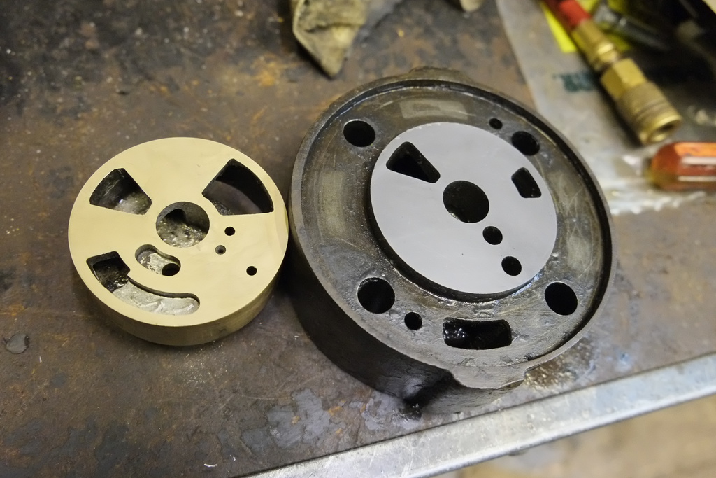

It took about 15 minutes on the lapmaster to complete the lapping job. This is with 9 micron aluminum oxide abrasive. I know some shops prefer 12 micron which will cut a bit faster. Not shown in the photo above, I used the lathe chucking fixture as an additional weight. You want to be at about 1.5 - 3 lbs/square inch of surface in contact with the lapping plate for best results.

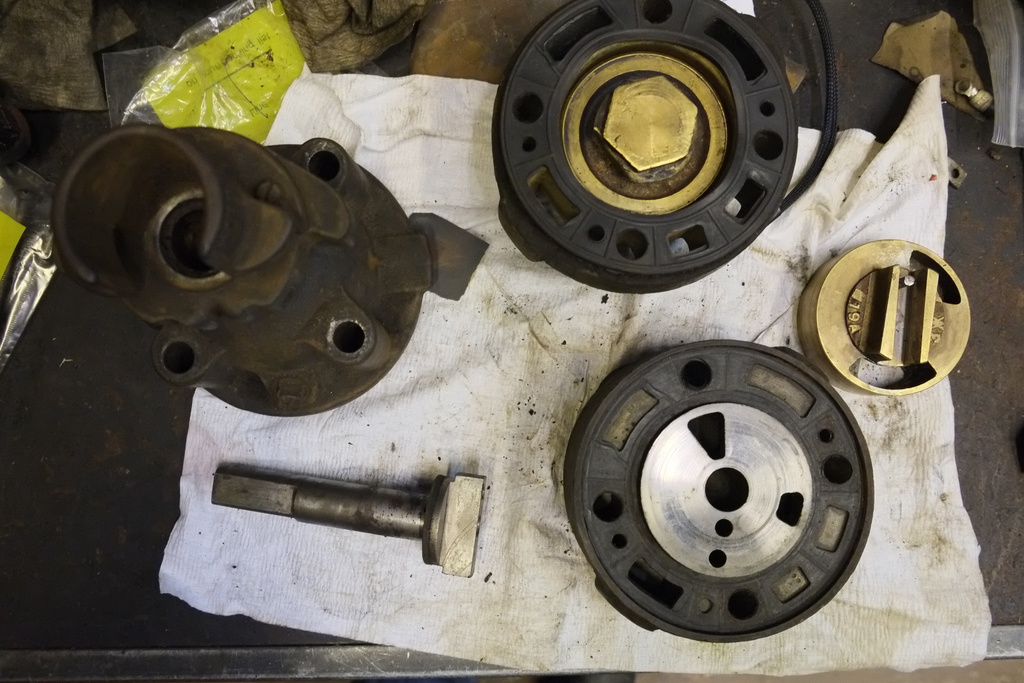

Here is the final result:
notice the even color and surface texture throughout. The lapmaster produces a dull "frosted" surface which when using the 9 micro abrasive will give a surface finish of 5-6 microinches. A polished surface is not necessary, but one does have to clean off all abrasive lapmaster slurry residue from the surfaces before assembling.
This particular valve, when assembled, was positively bubble tight.

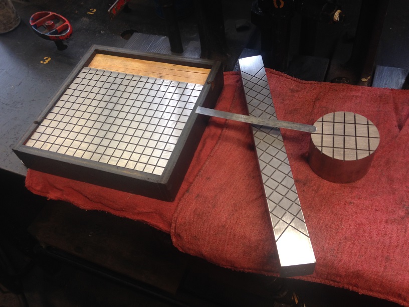

In conversation with Dave Garcia, I recall him singing the praises of some sort of abrasive block for slide valve cavities. While I haven't as yet attempted much research on this specific subject, I wouldn't mind seeing some literature and seeing these blocks in action. Thus far, we've done all our lapping with the plates/blocks as shown in the picture.
"There were limits that are out there for the height of the rotary valve seats."
Timely, as I was just looking at a book yesterday that called out these limits for a few brake valves. First time I recall seeing something like this.
-Erich

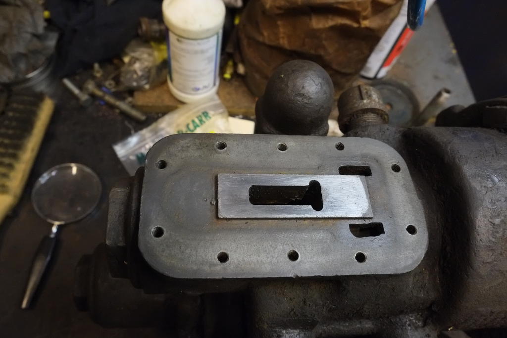

The topic of lapping stones has been brought up. I've had mixed results with these. Here is a photo essay of a recent project with a #6 distributing valve. This isn't a valve that I normally work on and I don't have much tooling made up for it. The valve was probably last serviced in the 1960s. You might recognize the application valve seat somewhere under all this sludge and rust:
This valve was a disaster. The seat was "hill and dale" visible with the naked eye. It was a close call. Take it over to the milling machine for resurfacing? (a rare opportunity, since slide valve seats on air brake equipment are usually inaccessible) Well, the valve is pretty heavy, and I didn't feel like spending 30 minutes or more figuring out how to set up machinst's jacks or otherwise to get the casting parallel to the machine, so two of us took turns going at it with a file! Probably would have been quicker the other way as it turns out. About 20 minutes of filing. This is the result:
The seat was very low at the leading and trailing edges to begin with. As you can see, we still haven't touched these areas with the file, but I felt they were far enough away from the port to move on to the next step.

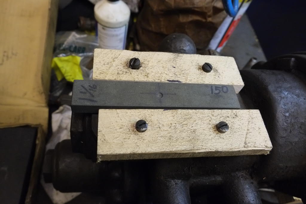

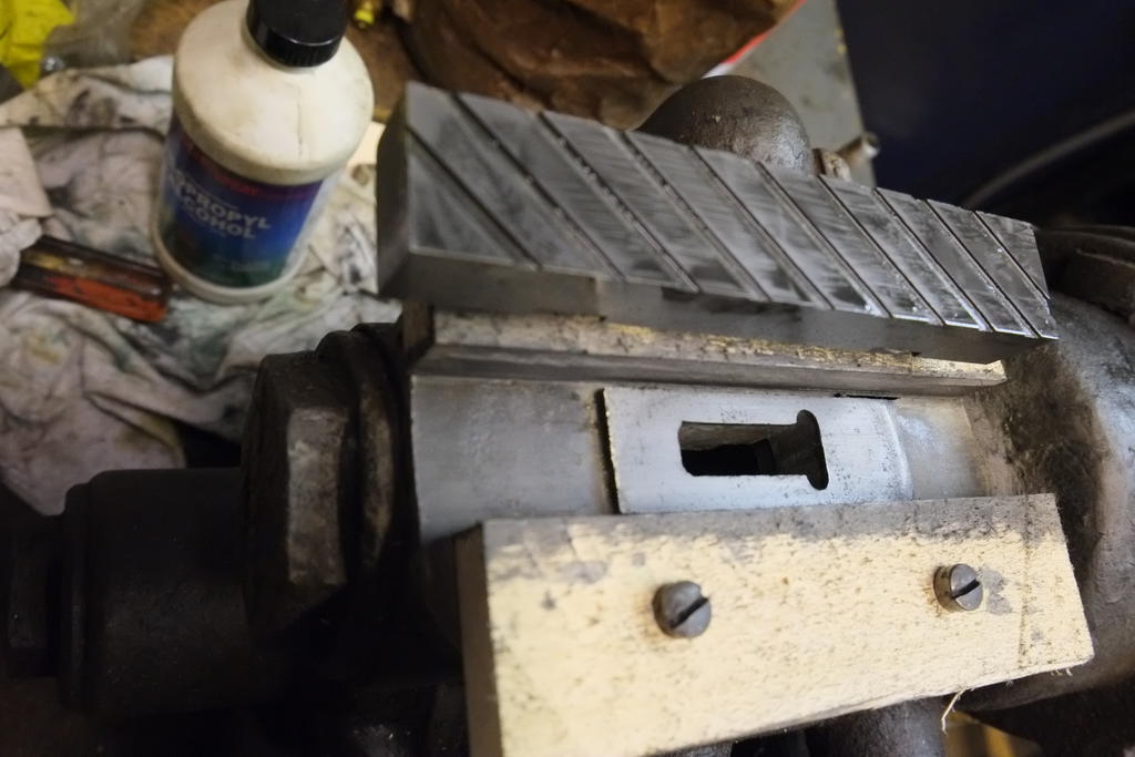

I have a few silicon carbide lapping stones. The late Dave G. got a bunch of these as samples from one of the major air brake repair vendors. I'm not 100% certain who the manufacturer is. One of them carried the "Sticks and Stones" label. It's possible the others came from Kansas City Abrasives. These companies carry 6" stones in a variety of widths and grits. The stones are not easy to cut. If you want to make a narrower one, you'll have to invest in a diamond bandsaw blade or slitting saw.
I used a 1-1/16 stone (which I have primarily for working on U4/UE-5 emergency portions) on the 1" wide seat. Normally this would be impossible since the stone won't fit into a narrower seat, but with this "open air" arrangement, I just made two crude lapping guides as you can see
I drilled a 1/4" hole dead center on the top face of the stone for use with various hook-type tools for working the stone back and forth inside a slide valve cavity. important note the stones are received from the factory are not very flat. So, how to you get stones dead flat? One suggested method is to use abrasive paper and a surface plate. This idea was DOA for the coarser stones. I tried 100-grit paper with this 150 grit stone and it just destroyed the paper.
What did work, but unfortunately I don't have a photo, is a very nice diamond impregnated stainless steel plate made by Atoma, a Japanese company. It comes complete with a little manual, totally in Japanese! The Atoma products are available in the US from a variety of knife foamer places. Placing this thin plate down on the granite surface plate, and using soapy water as a lubricant, I'm able to get the stone dead flat in a short amount of time. Secondary truing can be done on the Lapmaster, but doing so dulls the cutting edges of the coarse stones.
I use the same soapy lubricant when stoning the slide valve seat. When I used this with brass seats, loading of the stone was a problem. I was able to clean the brass gunk out with a brass wire brush. For the cast iron seat, I had no loading issue. If the stone glazes and stops cutting effectively, I am able to rejuvenate it with a few strokes on the Atoma plate.
The stones are not particularly quick. Here is the surface of the cast iron seat after about 30 minutes with the 150 grit stone:

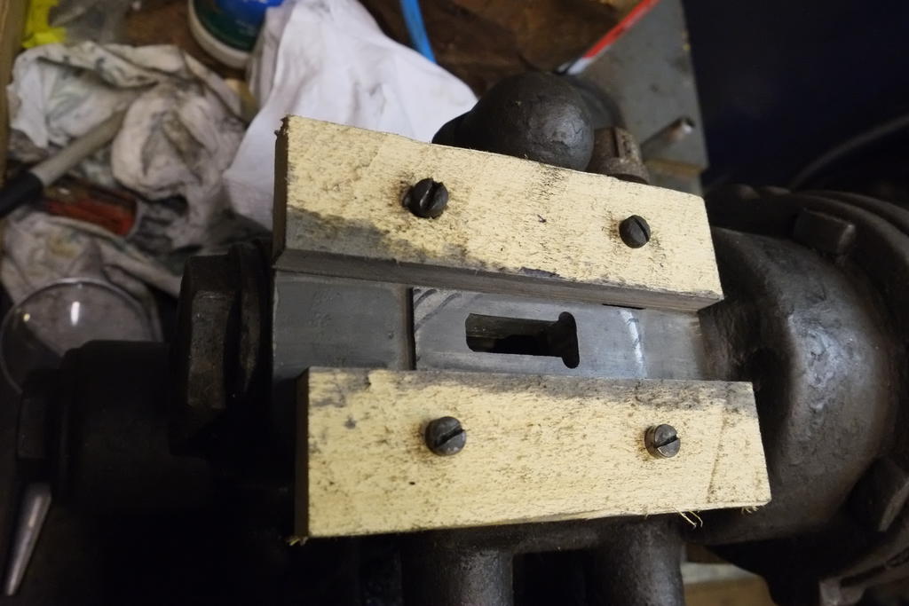

You see the front edge we haven't touched, as expected. Also a bad low spot in the back left and a smaller low streak at back right. Sometimes as you are going along, because things move so slowly, it is hard to keep track of what's high and what's low. So I'll stop, clean everything, and make some hash marks with a marker. I was at it another 10 minutes or so before switching to a 300 grit stone (no photos of that). 300 grit for at least 15 minutes. The 300 stone I rough initially on the 120 (equivalent) grit Atoma plate and then finish on the lapmaster. The lapmaster 9 micron is approximately equivalent to 700 grit.
I have 600 grit stone but I didn't use it here. Instead, I finished up with my serrated cast iron lap. I see Erich's laps are double-serrated. I always make them single, because I find the double pattern leads to weak spots, plus it takes twice as long to make. This lap is made on a Bridgeport, touched up with a surface grinder, and then lapped dead flat on the lapmaster. If I'm working exclusively with the cast iron lap, it will start with a heavy abrasive, such as 220 grit garnet paste, and then work up the grit scale. When I get to the 600-ish range, I just use the "lapmaster juice" that is already left behind on the lap. The lap needs to be re-trued on the lapmaster periodically. This is more the case when working with the coarser abrasive and early on in the process, when high spots in the work lead to ruts in the lap. At this point, near the end of the job, I just keep the lapmaster spinning, do about 30 seconds with the lap on the seat, and about 10 seconds on the lapmaster held by hand.
Looking for a uniform, frosted apperance. On this valve, I stopped short, chosing to ignore the low areas on the ends.
Btw, you may see there is considerably pitting on the cast iron surface. The end result was far from perfect, but it was acceptable. In retrospect, with the depth of pitting involved, I should have milled the seat and then milled the surrounding casting which would otherwise wind up below the gasket
