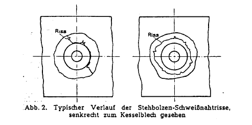

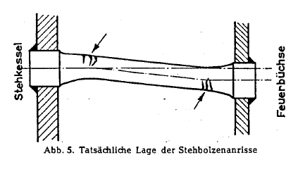

[quote=If the holes are "coaxially" true, then it would seem that a hole of near interference fit would be desirable without threads. The holes would be expanded at the welded ends to receive weld material.
Perhaps I am missing something? Are the holes opened wider so that the welded filets are carrying the load, leaving the stays room to "flex"?
.[/quote]
The staybolt grows from the heat of welding faster than the hole in the sheet and the induced stress of this plastic deformation leads to radial cracking after a period of time in service. Similar observations have been made by Greenslade (Flannery) as well as others (Tross) on threaded bolts with seal welds. Providing a sufficient clearance for growth around the entire diameter has been found to alleviate this issue.
Most staybolt body failures exhibit cracking which when mapped, often reveal a direction of bending towards gathering in the middle lower or hot zone of the sidesheets as these sheets shrink from service. The longer the staybolt is, the lower the bending angle and the more length this bending stress can be distributed over to reduce the stress that any particular cross-section along the body must take. Lowering the specific staybolt stress towards all cross sections being only elastically loaded increases service life.
