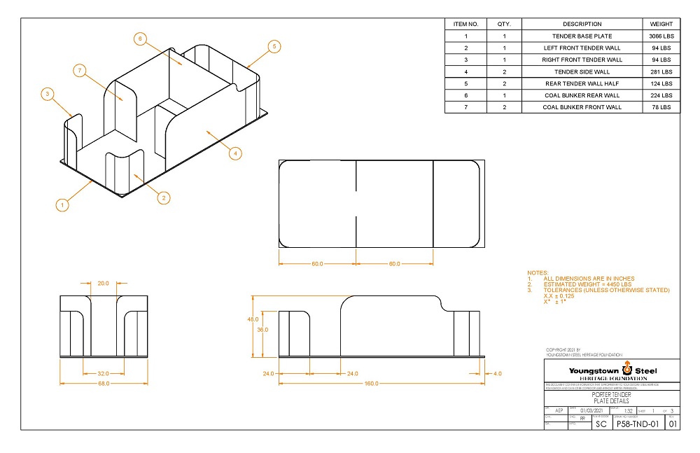

P58-TND-01_Porter Tender Plate Details Rev01-page-001small.jpg [ 99.45 KiB | Viewed 10583 times ]
Assembly drawing for the new tender superstructure

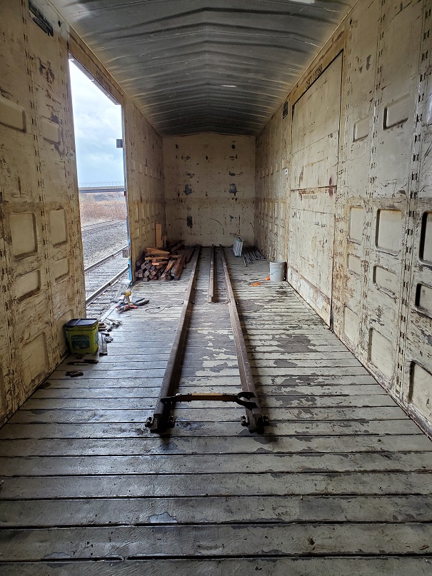

The new enginehouse with 24" gauge rails bolted to the floor. The new doors go on the far end.
