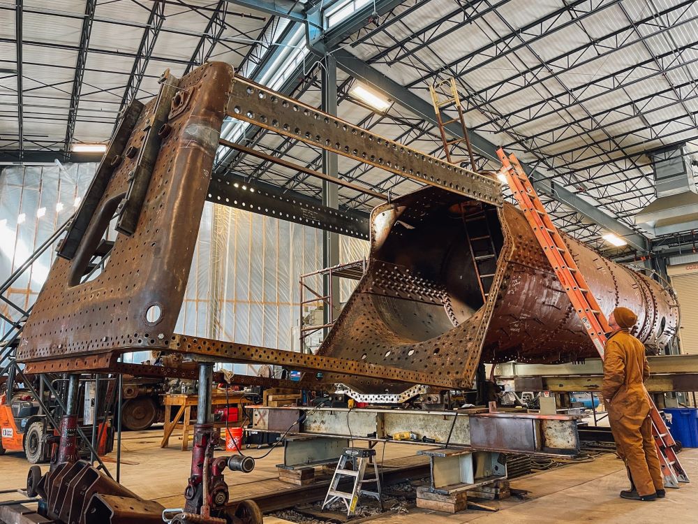

The Railroaders Memorial Museum would like to thank The Pennsylvania Railroad Technical & Historical Society for generously launching their $100,000 Match Challenge! We need a little more than $19,500 to reach the total campaign goal. This $100,000 campaign will go towards purchasing firebox material. Donate through the society and they will match your contribution dollar-for-dollar. Help fund the firebox material by donating via their website at http://www.prrths.org. Meanwhile, FMW Solutions has been working diligently to design and fabricate the replacement firebox. Here, the first two new pieces, the "Belpaire Sheets," are shown fitted to the boiler as Vice President of Mechanical Shane Meador examines the work. Your continued support is greatly needed! Learn more about The Spirit of Altoona at http://www.railroadcity.org/1361.
