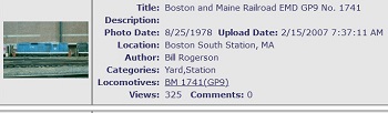

Hi All
Here is a shot at South Station, taken by Bill Rogerson when the B&M was working out of that location. Nice shot Bill and the unit is clean.
File comment: photo by Bill Rogerson nice work
