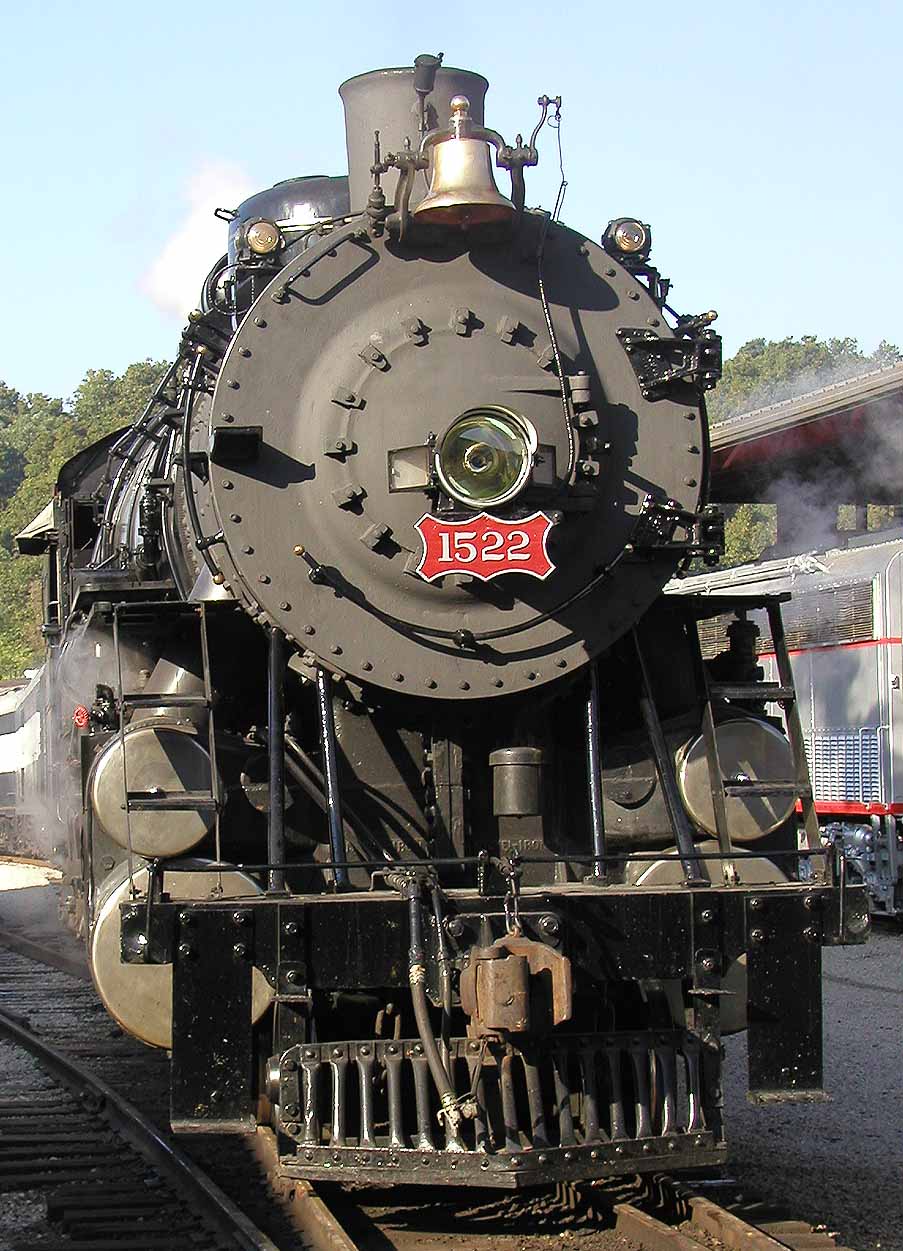

Kelly, that's exactly what I used. Never measured quantities. Mixed it in a coffee can. I used a parts washer wand with a pickup hose on it. Made a great graphite sprayer and you could control the spray. I had someone walk around with me holding the can and keeping the graphite in suspension while I sprayed.
Made very short work of the firebox with all those staybolt sleeves. That used to be a mess to do with brushes.
I wasn't there when the very first application was put on back in 88, but told the guys to use vertical strokes with the brush. They didn't.
I always liked the way the last method looked. It was bulletproof after the engine was fired up. I tried linseed oil early on and it really smelled bad so I decided mineral spirits was better along with steam oil.

Here is ours, straight from the engine house supply cabinet door.
Kelly,
Curiosity killed the cat.... How often do you have to apply it? And do you mind if I add that to my color data file?
Thanks.

I'm not Kelly, but you don't have to apply it that often. If you started out with a good sound surface it lasted a good while.
The photo of 1522 was taken right after our two farewell trips to Newburg and back and looks like it was just put on right before the picture.
