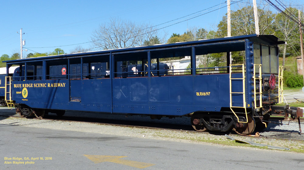

The old Wawa & Concordville used converted boxcars. Little River has two open cars that were either boxcars or stock cars. In both cases those were older, wood body equipment.

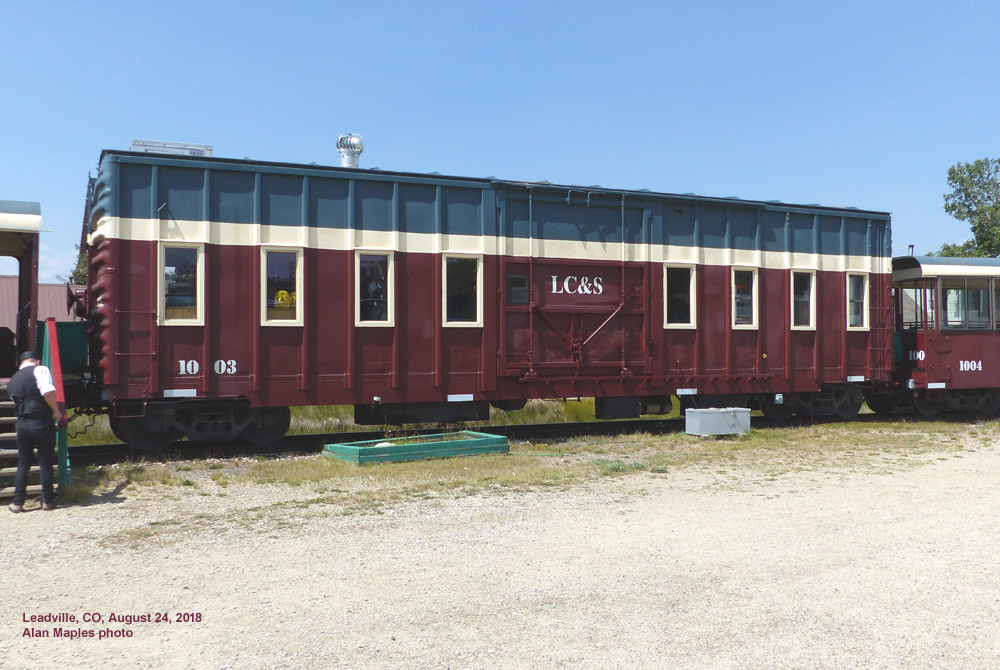

The Buckingham Branch passenger train has a boxcar employed as a concession car.
Gondolas are more common as open cars and it is probably easier to add a roof to a gon than to convert a boxcar.
I believe this is the Blue Ridge Scenic car referenced above.
- Alan Maples

Boxcar converted to concession car, Leadville, CO.
- Alan Maples
Leadville, Colorado & Southern, Leadville, CO Aug 2018.jpg [ 205.56 KiB | Viewed 20037 times ]
