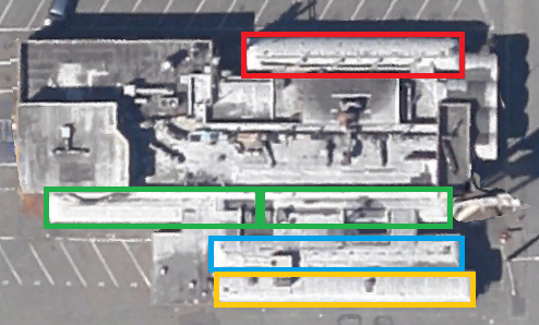

Rainier Rails wrote:
1. In the entry for the restaurant (http://www.bera.org/pnaerc-orginfo.html#Orient%20Express%20Restaurant), the Hicks-Hakner database lists an unidentified MU commuter coach: http://www.rrpicturearchives.net/showPicture.aspx?id=3994370
Well, unfortunately that's not the car that I had thought was the MU car in Andy's Diner/Orient Express. At one point I had been sent a photo (supposedly) taken inside the building showing what looked to be the end of an MP-54, so that was why I theorized that there was an electric MU car somewhere in the structure. Not having been there, it appears I was mistaken; the car in the photo looks more like an early steel coach and is almost surely not an MU car.
I've attached an aerial view of Andy's Diner (hopefully this works!) with the five railroad cars I know about highlighted. The Pullman obs car is in yellow, the unknown steel coach in blue, the two OE interurban cars in green and the Harriman car in red. Assuming that there aren't any other cars buried in the structure, I'd say it's a safe bet that I was in error about the MU car.

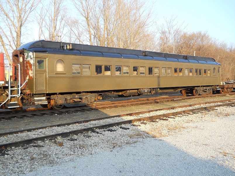

4. This coach is stored at the Mount Rainier Scenic yard in Mineral, WA, stenciled as BA&P #441; the trucks are stamped D&RGW. I have no further info on this car: http://www.rrpicturearchives.net/showPicture.aspx?id=3905885
Don't know for sure, but my guess is that this is a sister car to the one which I am part owner of, and which is located at the Hoosier Valley Railroad Museum in North Judson, Indiana (see photo attached). Note the similarities in window placement. It also has the step extensions. Car was built by Pullman in 1910 for the Western Pacific and later went back to the Denver & Rio Grande. The car has three D&RGW stamped trucks (the other one is stamped D&SL). Somewhere I have a list of where all these cars ended up and if I can ever find it, I'll post it here.
Well, after doing some more research, I think I can narrow this down:
Info from:
D&RGW #101 Abraham Lincoln website: http://www.pullman-car.com/index.html
"David.....and throwing stones" thread: http://www.rypn.org/forums/viewtopic.php?f=1&t=35746, in which Brian Norden posted the WP car diagram for #301-#340 on page #2.
First of all, the Lot consisted of a total of 51 84 seat coaches, built between July and October 1910. 40 of the 51 cars were initially leased to the WP as #301-#340, and the other 11 cars were owned by D&RG as #888-#898. After several years, 25 of the WP cars were transferred back to the D&RG, all renumbered by August 25th, 1918. The remaining 15 cars were transferred back to the D&RG between November 1923 and January 1924. The renumbering from WP to D&RG was not consecutive, the 40 cars were numbered from #899 to #950. The other 11 cars were eventually renumbered into this range. At least three of the cars that were formerly leased to the WP were later renumbered within this number range (see below).
To add to this, the WP car diagram shows that 12 of the 40 cars had a smoking compartment (with 24 of the 84 seats) at the men's end of the car: #301, #315, #322, #323, #327, #329, #331, #333, #334, #336, #339, and #340. I don't know if any of the 11 cars owned by D&RG had smoking compartments.
Also, in the "throwing stones" thread, Les Beckman states that most of these cars later had A/C installed, the cars that did not receive A/C were used for extra capacity and were later sold to Algoma Central, including the car that Les now owns, #899/#930. Note that this car would have been formerly leased to the WP, and was therefore renumbered twice, once upon return to D&RG and again at a later date (see below).
Now, the car located in Mineral, WA, as BA&P #441, still has the partition for the men's smoking compartment and did not have A/C installed, so this would (likely) be WP to D&RG(W) to AC to BA&P.
