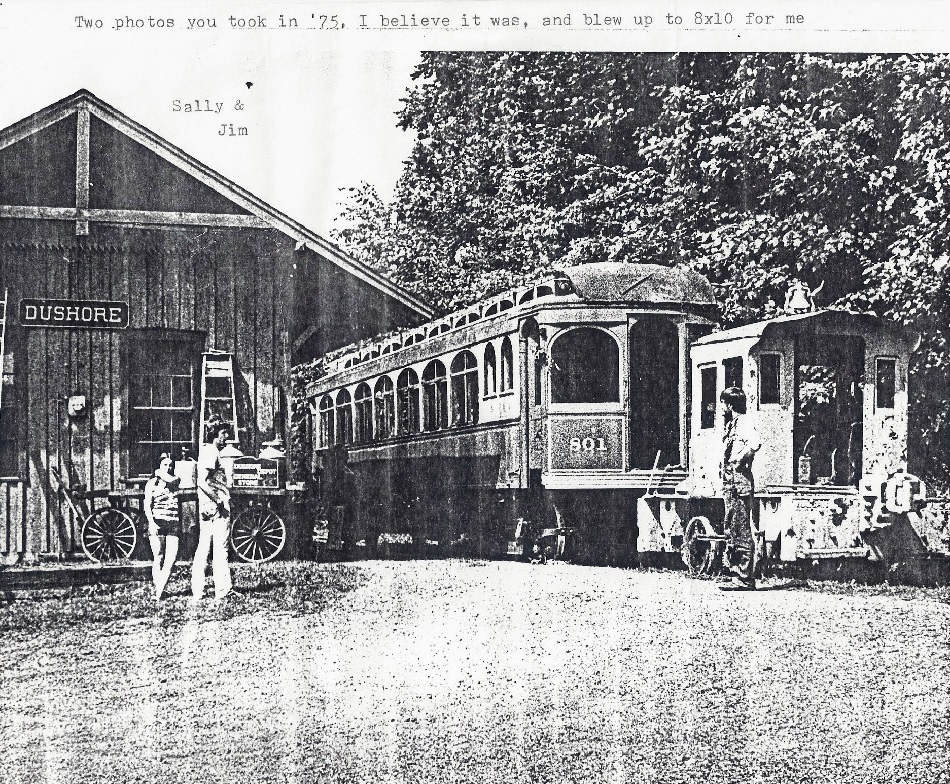

Sorry so late to this topic, but I just came across a few old photos of Liberty Bell 801 from Dushore, PA. I worked for two summers with Ed Blossom and others on the trolley restoration in Dushore. The attached picture in not very good quality, but it does show the Dushore railroad station and car 801, probably 1975. That's me standing to the left with my sister, and Bill Cluley standing by the Vulcan(?) locomotive that we used to move the car around. Typewritten note at top of page is from Ed to my father, Dr. Tom Shoemaker.
