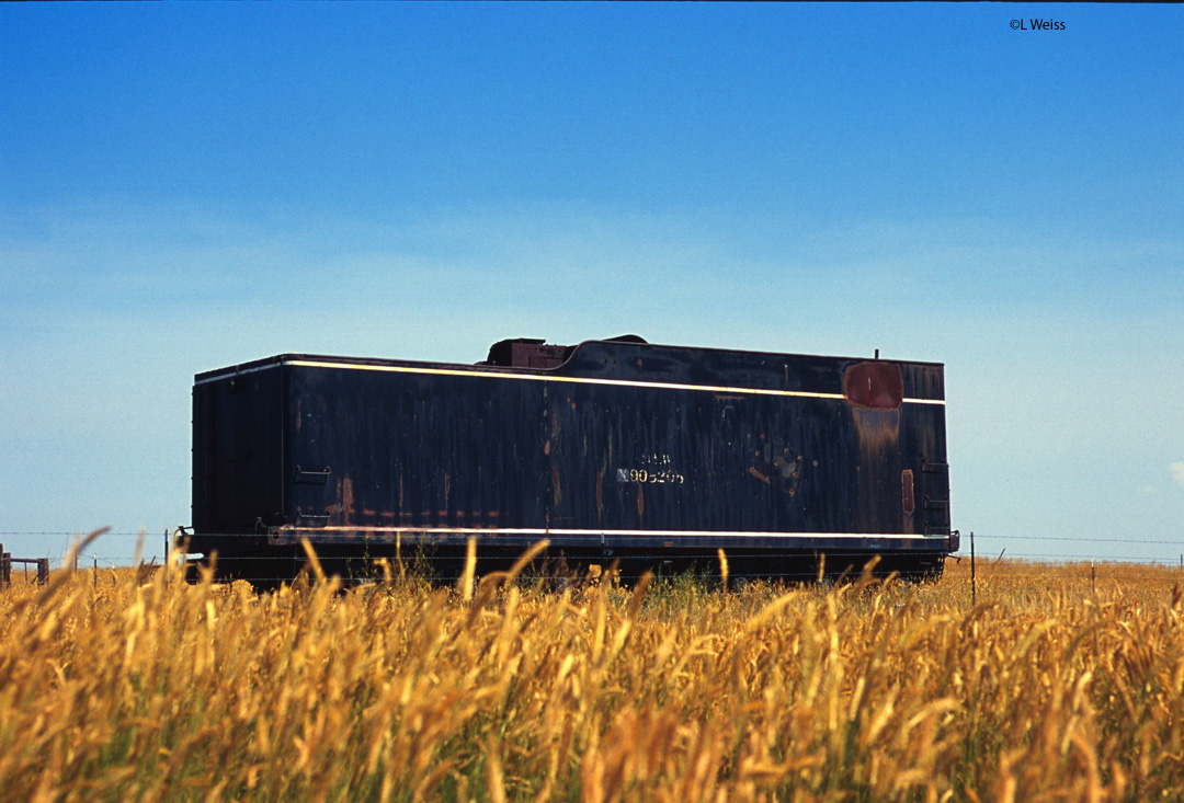

I believe the tender is from an S2 4-8-4. Left behind when services were discontinued. There’s a photo of it from 1980 so it must’ve been before that
The number on the side is 905208 I believe, it’s hard to tell because of photo quality and painting of those numbers. That might help in identifying the car.

To my knowledge, it was common practice to for many railroads to keep equipment to their original numbers, but if the equipment was repurposed, in this case Maintenace of Way, they'd add an 'X' followed by a three or four digit prefix number. Many repurposed tenders and water tanks on the MILW were in the X908 series. Considering this is X908208, more than likely the locomotive it came from was engine 208.

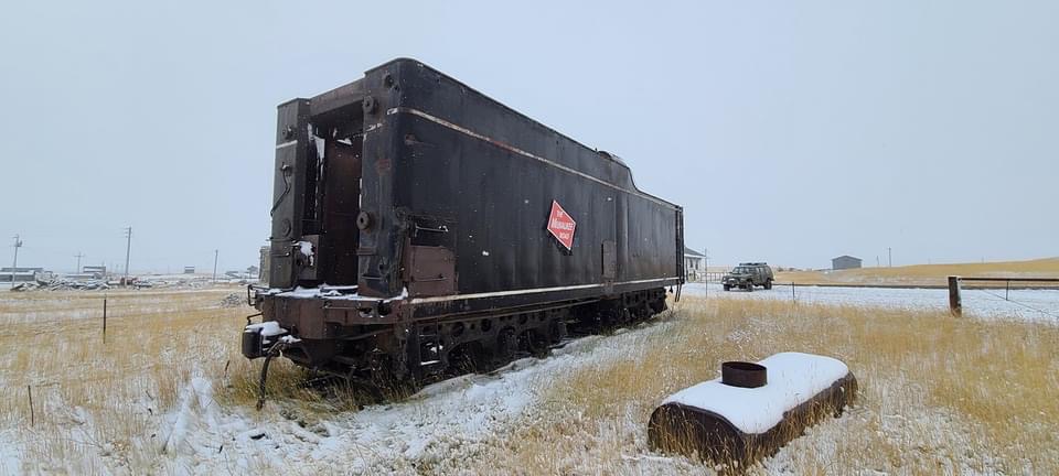

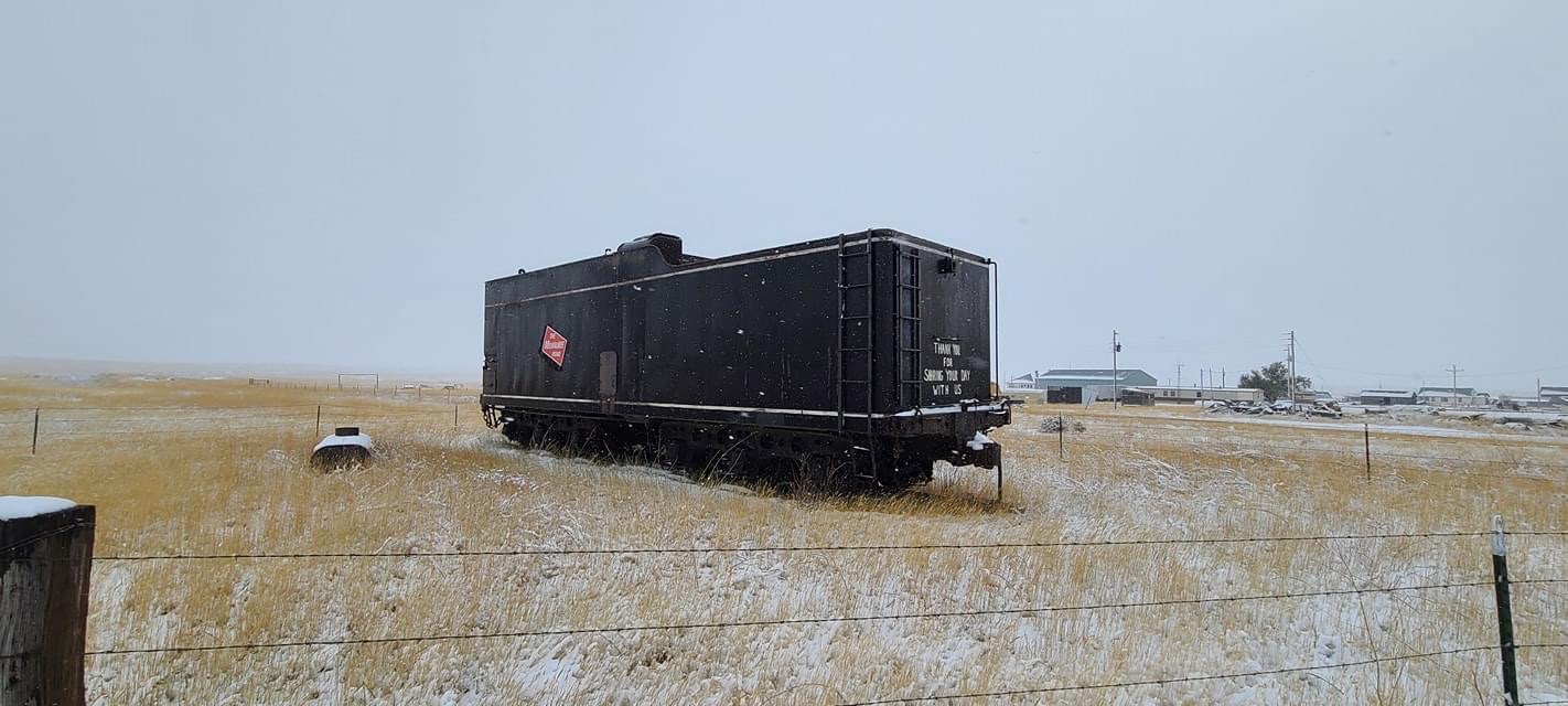

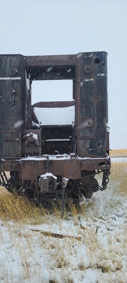

Recent photos of the tender just showed up on the ahead of the torch page on facebook page. I believe the tank MLW 261 runs around with is former N&W, so if they were ever looking for a more historically appropriate canteen car.....
