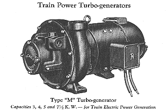

I am looking for information on the Pyle type "M" turbo generator.
Thanks
Tim

What do you want to know?

I am looking for pictures from the sides and the top. A detailed picturs of the lettering and tags.

OK, will check my stacks of stuff. I know I have some technical stuff, not sure about artwork.

No artwork on the type M, closest I have is MO6. Sorry. Maybe somebody out there is using one and can take pictures for you.
Dave
