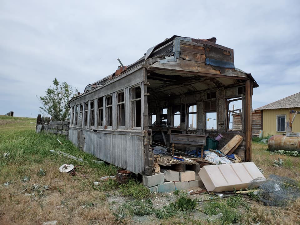

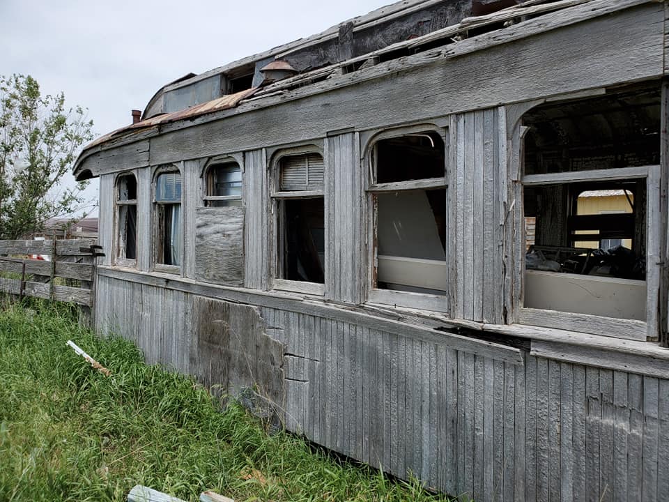

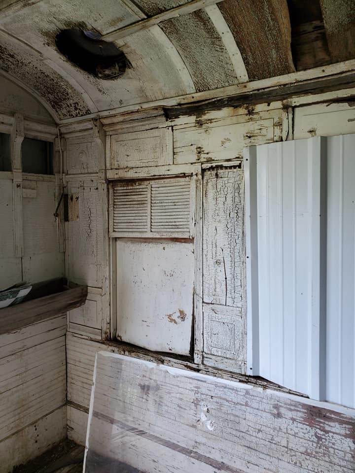

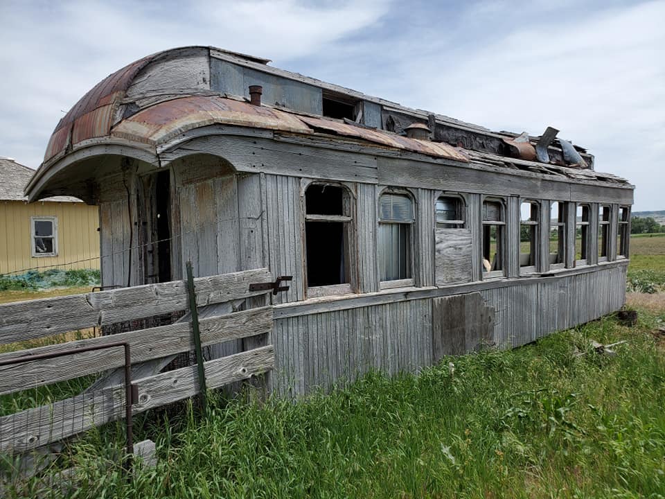

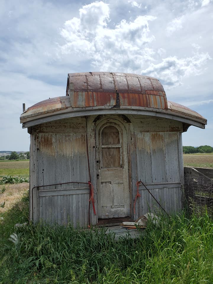

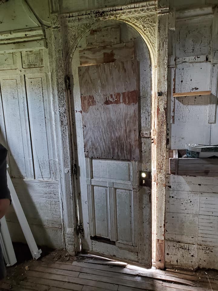

After seeing an ad on FB marketplace i went to a site near Douglas Wyoming and found half a 1880s ish passenger car. Clearly the internal details were spectacular with wood window blinds and ornate carvings everywhere, but what was it ? it was in the right area for CNW, CBQ and C&S. On one of the clerestory windows was the number 2674 which could have been a Lot number or car number. further research and sanding showed bright yellow paint as the first applied color and this leaned towards CNW. After appealing on FB (yes Facebook again) we came up with 1882 CNW CAR 2674 a twelve wheel smoking coach built by the Ohio Falls Car Company and listed as destroyed in 1926. It was Lemon Yellow with ultramarine blue letter boards and gold and red pinstriping, interior is mahogany.
It is so incredible inside that an urgent appeal is out to recover the remains before they are bulldozed and get them out of danger even if we subsequently dont restore it as part High Plains Railroad Preservation fleet.
Mike Pannell
Cheyenne

 Post subject: Re: 1882 CNW car found....well half found
PostPosted: Thu Jun 18, 2020 1:07 pm
For those experts here, when presented with a parts source like this, what items would you prioritize stripping from the car?
PostPosted: Thu Jun 18, 2020 2:24 pm
Steven -
I don't see it as a parts source. What I would envision would be a restoration (IF it was deemed possible), then put it up on an appropriate truck, rebuild the end platform, and with the other end set so the car was level, put it up against a mirrored wall. On the outside, it would appear in its full length, and to folks allowed up on the platform, the interior would also appear to be full length. Of course you'd have to find a museum that had an appropriate indoor hall to display it, but I think it could be done. Too much there to just let it go for parts. My two cents only of course.
PostPosted: Thu Jun 18, 2020 3:31 pm
car57 wrote:
Headend Shield wrote:
Is bulldozing imminent?
As imminent as any owner says it is...... he wanted it parted out as barn wood, i said lets not !
Mike -
Good for you! Hope that the 1/2 car can be moved and eventually restored. Are there many cars left from the Ohio Falls Car Company?
PostPosted: Fri Jun 19, 2020 12:24 am
Posts: 483
Location: Oroville, CA
the photos may be fooling me, but it sure looks like way more than 1/2 of a car. I have seen worse cases brought back, it sure looks "ripe" for a full restoration/reconstruction. I hope you are able to save it. For something as scarce as this, parting out would seem like a sad second choice (but better than loosing it all).
Steamcerely,
David Dewey
PostPosted: Fri Jun 19, 2020 12:58 pm
David -
You may well be right about it being more than just 1/2 the car. Two ways to know for sure; either blueprint/diagram or a photo. Any chance that either might exist?
PostPosted: Fri Jun 19, 2020 1:48 pm
Posts: 140
Location: Northern California
I agree that this probably is almost all of the car. It's a gem and a trove of historical information. Any disassembly should be done very carefully with more photographs than would ever seem necessary.
Joe Magruder
PostPosted: Fri Jun 19, 2020 1:59 pm
The internal trusswork in the walls will allow you to interpolate an overall length for the between-bulkheads measurement.... which I'm cure you already know. Whether that's half or most of the carbody, it's great - and if simply cleaned and stabilized would be an interesting way to interpret early adaptive reuse and what happens after decades of it.
PostPosted: Mon Jun 22, 2020 8:57 am
Posts: 825
Location: cheyenne
Its exactly half of a 38 window 61 foot car, we have original drawings for it and the CNW car register page and it appears in Whites American railroad passenger car Vol 1 pages 98 and 99 it ran on 6 wheel trucks and was built in 1882, interior was maple (blinds) and mahogany, exterior was lemon yellow with ultramarine blue letter boards and gold and red lining. we are currently getting quotes on moving options and a Go Fund Me is in place.
i have removed and restored one window blind and one clerestory window.
Mike
