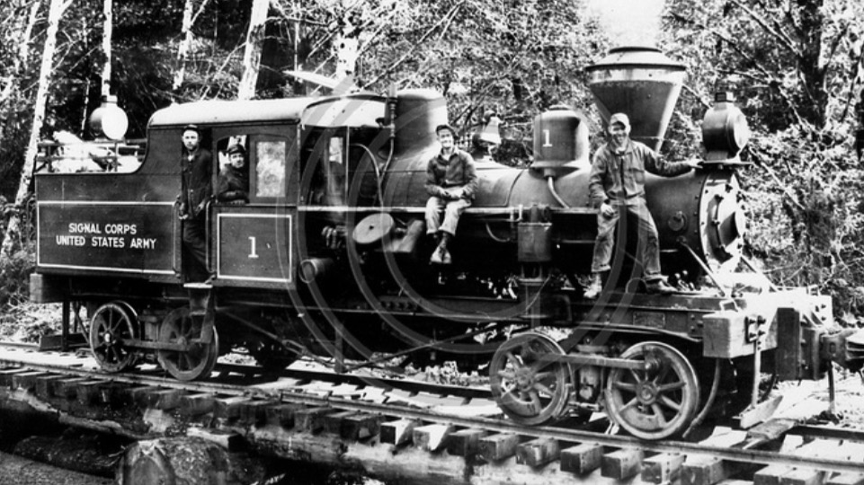

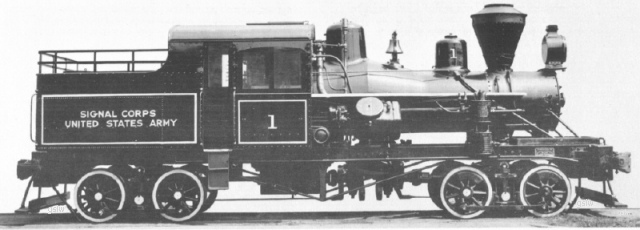

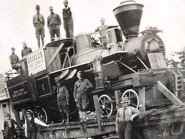

Seldom found in 1918:
Pics of a steam locomotive in the year of manufacture in three different locations from different photographers.
Heisler c/n 1373 36ton for Spruce Production Division in Yaquina, OR
Built May 1918
1. Factory in Erie, PA
2. Arrival in Yaquina, OR
3. Operating in Lincoln County south of Yaquina, OR
What get my attention is the delivery on a T&NO (SP) flatcar.
Heisler Locomotive Works had direct rail access to the New York Central RR and the Pennsylvania RR.
Also New York, Chicago and St. Louis RR (NKP) go directly through Erie, PA just south of the factory.
It would be more logical to use a flatcar from one of these railroads?
My question - was in 1918 something like a national pool for special cars like it was for box cars?
Or did during USRA controlled rail operations nobody care and they take everything available on any location?

If that's the same locomotive in the same year, it sure didn't take them long to get the trucks apart and then mis-matched. They will operate ok like that, but most owners made an effort to skid the truck along until it would mate up with the shaft and have the side rods in the same position.
I had experience with this in the summer of 1970 at Castro Point on ex-Pickering Lbr. Corp number 5. All we had at night was a single incandescent light to work with, but a lot of sweating and swearing got the engine back together in time for a July 4th operation.

Since the Spruce Division was all wrapped up by the end of 1918 all three photos were most likely taken in that year. As to the TO&E flat car, the probably used the car that was available.

Car service rules called for a foreign road car to be loaded (preferably) and moved to or at least toward its owning road. T&NO was, of course, in Texas and Louisiana, but it was a SP subsidiary. This move to Yaquina Ore. took it to the SP in Oregon.
As to the Signal Corps, they need trees for telegraph poles.
