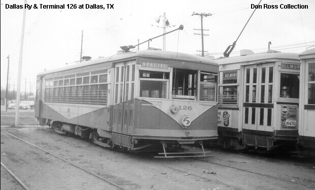

The DR&T wartime paint scheme was willow green, cream window band separated with a red stripe and a pearl gray roof. The window sash were definitely cream. Bare brass would be inappropriate as well costly to my efforts because if the copper mice figure it out, the windows would be liberated. They will definitely be repainted and reglazed before being reinstalled.
File comment: Dallas Railway & Terminal Double Truck Birney 126 in V Paint Scheme - Picture from Don Ross's website
