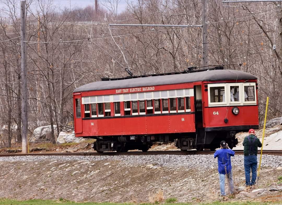

File comment: Car 64 running in Pennsylvania
In 2002 we used vinyl lettering in East Troy on a painted metal surface on Strafford car 64. The letters were applied by a local sign shop and were of exterior quality. Today, the car is at the Electric City Trolley Museum in Scranton, and still looks good and the lettering hasn't fallen off. .
Surface prep is always important. The car was painted using oil-based farm tractor enamel.

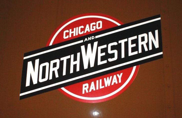

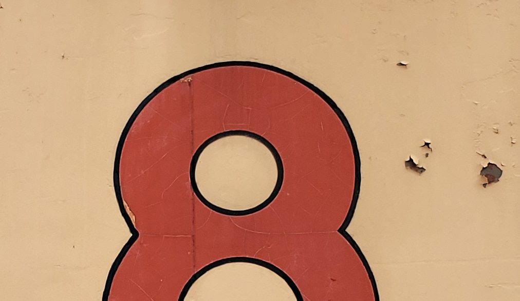

As a follow up to the earlier post I took pictures today of some of the IRMs vinyl work I have done over the last 20 years.
File comment: The CNW heralds were were done by a local shop with printing over reflective white. First photo new in 2006 to a jeep, and after 14 years outside the red is gone. Black somewhat faded and the vinyl itself looks a little cracked. Our CNW 411 F7 done about the same time is stored inside and the vinyl still looks OK.

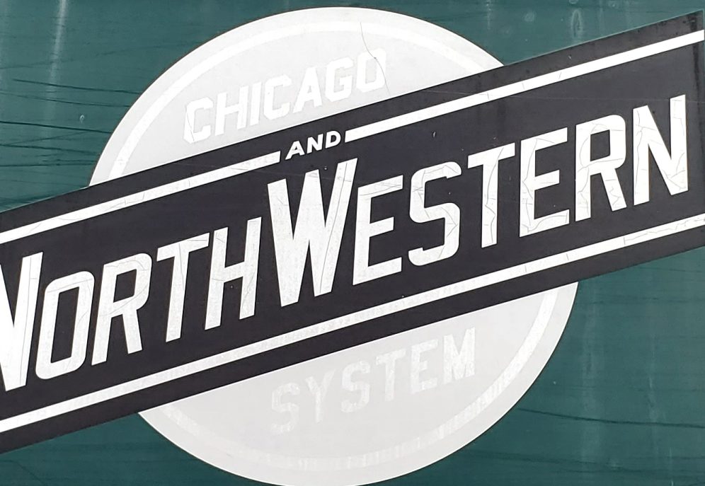

File comment: As a comparison the Turbine vinyl number 18 was put on 20 years ago. The red still looks red because this is not printed on. It is reflective red vinyl with a black heat transfer film border. Starting to peel but still doing much better outside than the printed process.

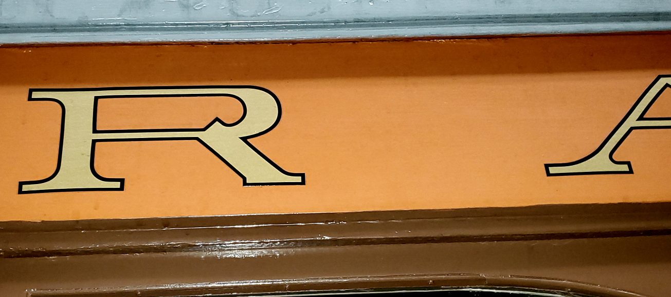

File comment: I saw the post about not applying to wood and although I concur we have put it on wood with good results so far.
Rapid Transit 1268 was done in 2011, we needed to recreate a letter-board originally done a hundred years ago in hand applied gold leaf with a black border. Get a price on that from your local sign shop.
The original wood after striping was panted with sanding between coats to make it as smooth as possible. The metallic gold with black border vinyl was applied a few days after the pant dried. Stored in a unheated, uninsulated barn in Illinois for 9 years still looks OK.

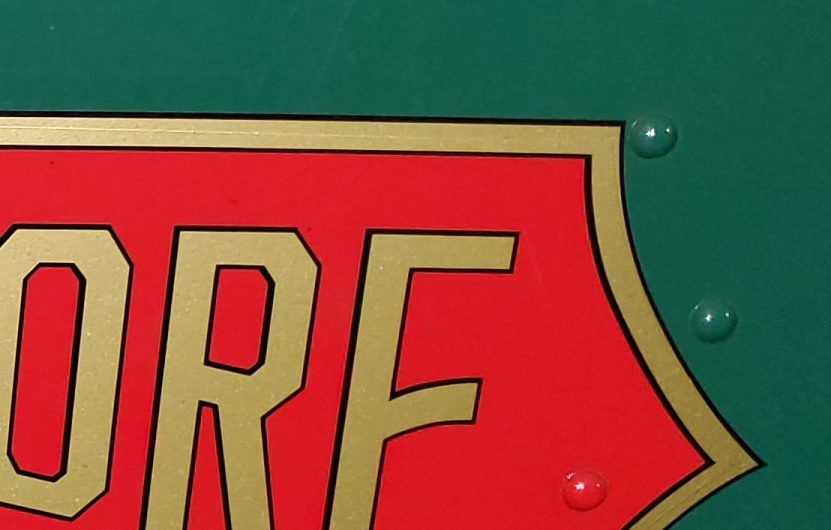

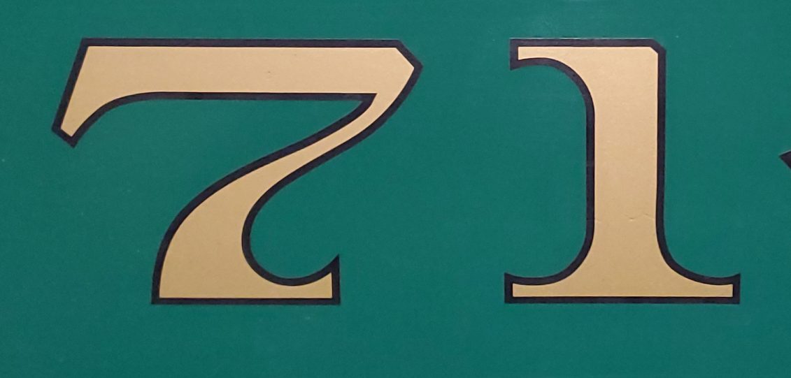

File comment: I have a couple closeups of North Shore 714. Completed around 10 years ago, to match the red herald color we painted the red using a mask to the size of the Gold/black outline. So the vinyl was again metallic gold with a black border for both the herald and reporting numbers. Same unheated indoor storage the vinyl looks fine.
