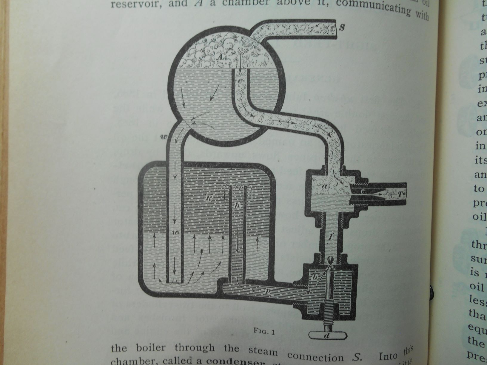

here is a drawing for a hydrostatic I swiped from an 1920 ICS book. This drawing shows how the water and oil intermix.
Robby Peartree

Russ,
Thanks a lot for the explanation. It seems that the critical part is that I was expecting the pressure to reach atmospheric pressure before the water and oil flow stopped (at which point it the fluids would be slowly dribbling out), when in reality, the pressure will still be falling at that point. Thanks also to John, Earl, and Robby!
