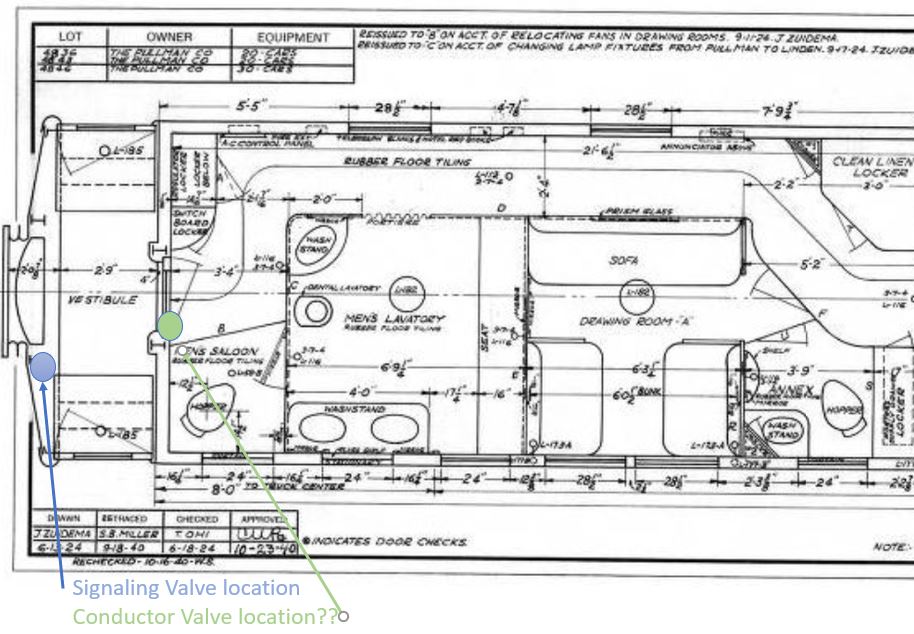

Hoping that this is an easy question:
Examining a Pullman Sleeper from Plan Series 3584 which the Pullman spec by my reading implies that there are two conductor valves and two signal valves. This car was converted twice and ended up in MOW service. I can't locate where the Conductor Valve (Brake) would be in the car.
I can see where the signal valves were located in the vestibules (and the retainer valve) and located where the signal pipe was removed along the length of the car, but the air brake line is continuous from one end of the car to the other end (except for the UC valve). I can find no locations where a branch would come off for the Conductor Valves and no location for the valves in the car.
The best that I have found for the valves is two ~3" holes on each end of the car currently covered with a circular wood disk with wires sticking out of the wood. These covered "holes" are located inside and high above the main car doors that enter from the vestibules. The circular wood covers are located on the hinge side of the door which if they were the original valve locations seems to put the conductor at risk of having a door smash the conductor against a wall, but they are up high so at least not likely to be accidentally pulled. The nearest hallway light per the plan is on the opposite wall that you see as you enter the car.
Other than that I can't find anything in the car or in the drawings/documents that I have. The spec says originally two "New York, type 114 S.C." valves in Paragraph 157 Titled "Conductors Cock or Valve". (Paragraph 160 says "Air Signal: two New York"). I'm expecting that the 1st one is the Conductors Valve and the second is the Signalling valve.
Anyone able to confirm or deny the location or suggest an alternative location for the conductor valve?
Not sure where the conductor valve lines would connect either.
Thank You for your thoughts
File comment: Screen shot of image with possible valve locations added
Capture Sleeper Signal and Conductor Valve poss Locations.JPG [ 117.44 KiB | Viewed 9331 times ]

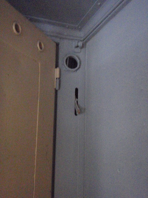

Got out to my car yesterday and snapped a picture of the conductor valve lever

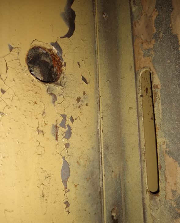

Sure enough, I looked carefully and found those slots on both ends in the cabinets - I don't recall noticing one of the two previously but there were items in the way. Very nice to see the pulley in the picture posted by PRR 7099 earlier; much appreciated. It all became much clearer with that picture.
I opened both cabinets and found no piping unfortunately (also no pulleys outside, but holes where the screws had been), but did find a >1" diameter hole in the wall inside of both cabinets (see picture). I suspect the holes were associated with the conductor valve and somehow it appears that they managed to remove the pipes at both locations many years ago.
I am thinking that I can get a standard 3/8" steel pipe and fittings back into the opening and out the bottom of the car (also found a similar sized hole exiting beneath the car).
Is the air connection of the conductor valve made through the hole in the wall (see the picture) for the Pullman cars of this vintage? A related question (similar to comment by EJ Berry earlier in the thread), does the conductor valve just vent into the cabinets (I didn't find a clear indication of an exhaust pipe location in the cabinets)?
I have access to a B-3-B valve to use as a Conductor Valve and it seems that it will fit the slot just fine. Not sure if the recently posted picture was the New York 114 S.C. valve or something like the B-3-B, but I am thinking that I can make the appearance similar.
Thank You
File comment: Wall opening for brake pipe (left)? adjacent to slot opening to cabinet (right); angle strip securing cabinet to wall (center)

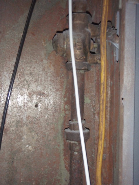

here is a photo in the electric cabinet - sorry for the cord in front of the valve in the picture

Steelgrinder - You need to do a bit more searching, under the car. Find out if the car has E-3 valves which would be piloted by the conductor's valve. I'm betting you will simply find a "T" in the brake pipe which is probably plugged. A B-3-B valve is used to pilot an E-3 valve which actually makes the emergency brake application by essentially opening a large hole (about 1") to rapidly deplete the brake pipe and trigger the emergency application. My memory of heavyweight cars -- and it has been years since I have done a brake job on one -- is that they used B-3-A or even 1" angle cocks and larger diameter pipes (1" ?) to connect the conductor's valve to the brake pipe. I am not at all sure that a B-3-B would provide for a sufficient volume of air to initiate an emergency brake application. You need a bit more research to safely connect the conductor's valve to the brake pipe. All you are doing is a cosmetic restoration on a display car, I guess it is another thing entirely. Still, even in a museum situation, sometimes cars are switch around and I have seen cars get away with someone frantically pulling on a conductor's valve and getting nothing...

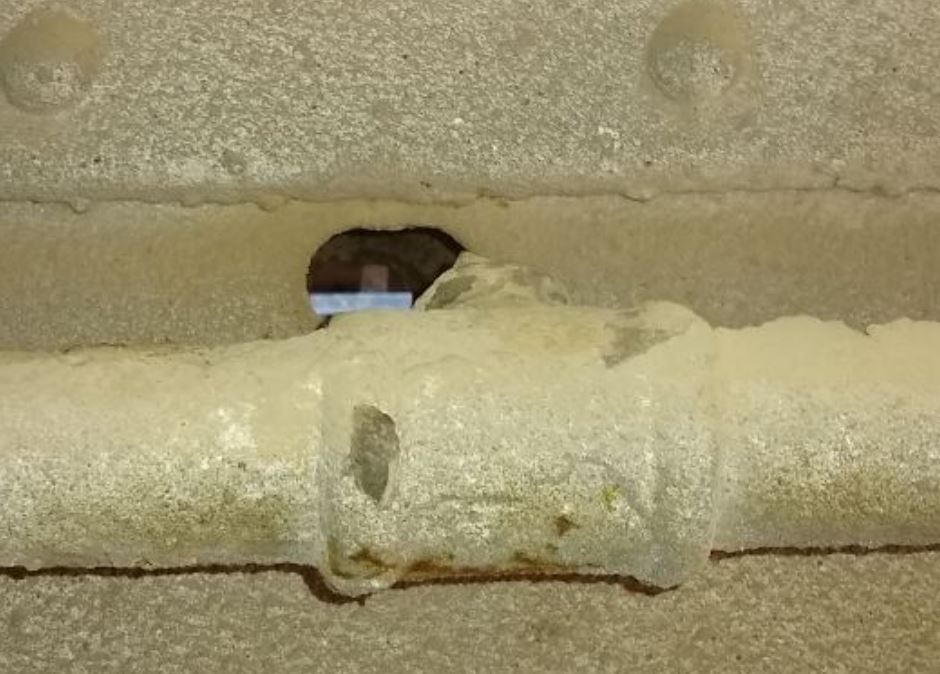

2) Based on input from Catalpa I looked closer one more time and discovered the Tee in the brake line that I had overlooked before. The Tee is located past the Center bowl but above the trucks. There is an oval opening in the two Center Beams to allow the pipe to pass through. The flash from the camera makes it easier to see in the photo. The Tee branch opening is at about a 45 degree incline (maybe less) to pass over what originally would have been the signal air line (at least it appears that way). All of these observations also help to support that the larger 3/4" valve and pipe is appropriate.
For reference for anyone else (on a 1920's era Pullman): I would estimate that the crossover point is about 11 feet behind the Conductor Valve on the car. The openings for the pipe in the beams are somewhat close to the floor that is above the beams (and the cross over is above the truck as well). It appears that there are some brackets to support the pipe in a few places under the floor and also one to stabilize the vertical run of pipe in the cabinets where the conductor valve is located.
Some work to do for sure but at least a clearer path to a solution. Much appreciation to everyone's contributions to the thread.
File comment: The outlet (plugged) of the Tee is just visible on the far side of the Brake Pipe and the oval openings behind the Tee were for the pipe to reach the other side of the car.
