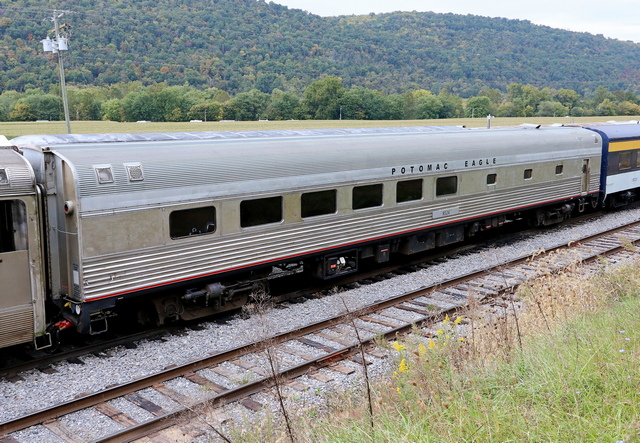

NKP779 wrote:
Dale, Sorry but I am not familiar...............where is the 8524 and who owns it?
#8524 Has entered Service on the Potomac Eagle out of Romney, WV
