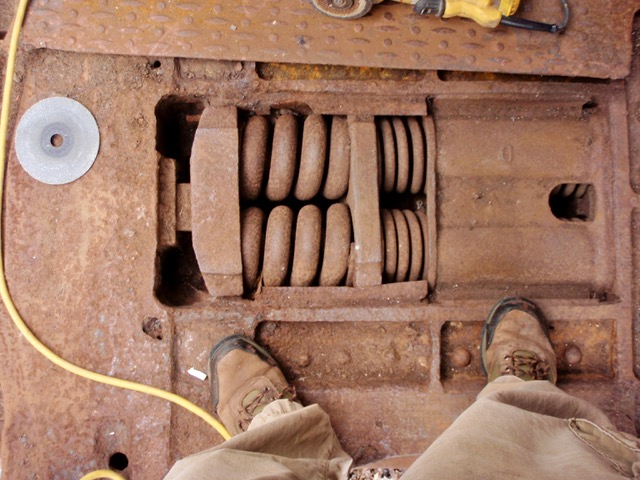

On my car I found that the rails that the guide the traveler for the Center Buffer Stem had corroded (gone) and also Center Buffer Stem was rusted frozen to the car. My welder rebuilt the rails and we spent days cleaning out the path of the Center Buffer Stem. The springs were good and loaded with energy. Be careful.

That is a nice photograph to have showing the condition and arrangements of the components. I appreciate you posting that. It is a far better photograph of the mechanism than I have located in the Pullman Catalog.
The springs in the car I am working on are compressed just a bit more than those in your picture -I'm guessing that they are under just as much load if they are not broken.
Is there anything you can say as a basic summary for how you approached getting the load off and/or getting the Center Stem free?

My welder was able to compress the springs enough to remove that carrier plate at my left foot in the picture. Then carefully removed the springs. With the springs out we spent days working to break the Center Buffer Stem free from the rust it was frozen in. The old shims were steel and solid rust fused to the car.
Cleaned it all out, rebuilt those guide rails and resembled.
Have you / can you, remove the buffer plate? If you can't compress your springs you might have to and then start your project by breaking the Center Buffer Stem free and then working inward.
Hard work but, isn't the Pullman HW infrastructure impressive?
