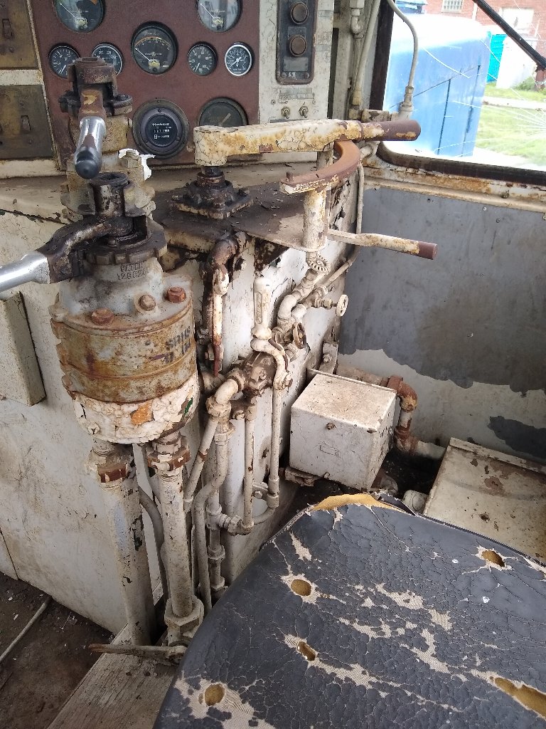

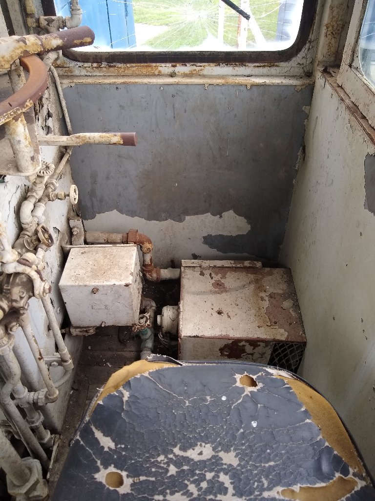

While we are shutdown due to covid, like many other museums we are still working on projects and displays.
Anyway, we are working on cleaning up the cab of our 45 and adding tags. One item I am not seeing is a bell control valve. Most GE's have it just above the heater.
Attaching pics, does anybody else see it where maybe I have missed it? I am wondering if it and the horn operate together and the bell only rings when the horn valve opens but the plumbing doesn't look like it is routed that way.
Thanks
Bill

While I have no experience with 45 Tonners, I"m familiar with 44 Tonners. The 44's that I ran had the sand and bell valves mounted as you stated, just below and in front of the engineer's window, over the heater. On those, the bell valve used the same air source as the sander valve. Looks to me like the stem valve in front of the sander valve may have been where the bell valve was mounted.

It should be that round-handled stem valve pointing up right under the reverser.

I dug out the operators manual for a 44 - don't have one for a 45 - and the sander and bell ringer valves are mounted on a bracket fastened just maybe 5-6 inches below the window on the side wall - not the end wall - of the cab. Bell valve is a simple single lever two position valve (open / closed).

Since we have both a 44 tonner and a 45 tonner I went and had a look today. Both have the bell and sander valves in the same place, on the side wall of the cab in front of the Engineer's side window, as Dave described.
The bell valve handles on both units have the word "BELL" cast into them.
Our two are later units, both built in 1956. Earlier units are likely different.

Here is our 1941 built 45 tonner; bell valve is circled in red:
The small brass valve to the right of the bell valve is for the windshield wiper. The sander valve is below that, clearly labeled.
Here is our 1950 built 45 tonner (pardon the mess, she's awaiting restoration); bell valve circled in red:

So the maintenance manual shows it along the front wall but each one is different. Hmmm
The stem valve aimed horizontal directly below the reverser in ours is connected to the wiper. The one just above it has a stub of broken tube hanging from it. I can see in the paint where said tube went up the wall along the horn line through the wall and outside you can see where it went across along the cab roof. Pipe from the bell looks to run up directly under the cab. Me thinks someone made off with the original valve.

Here is the bell valve circled in our 45 tonner, which looks almost identical to yours. The little red oval valve behind it is for the front wiper.
