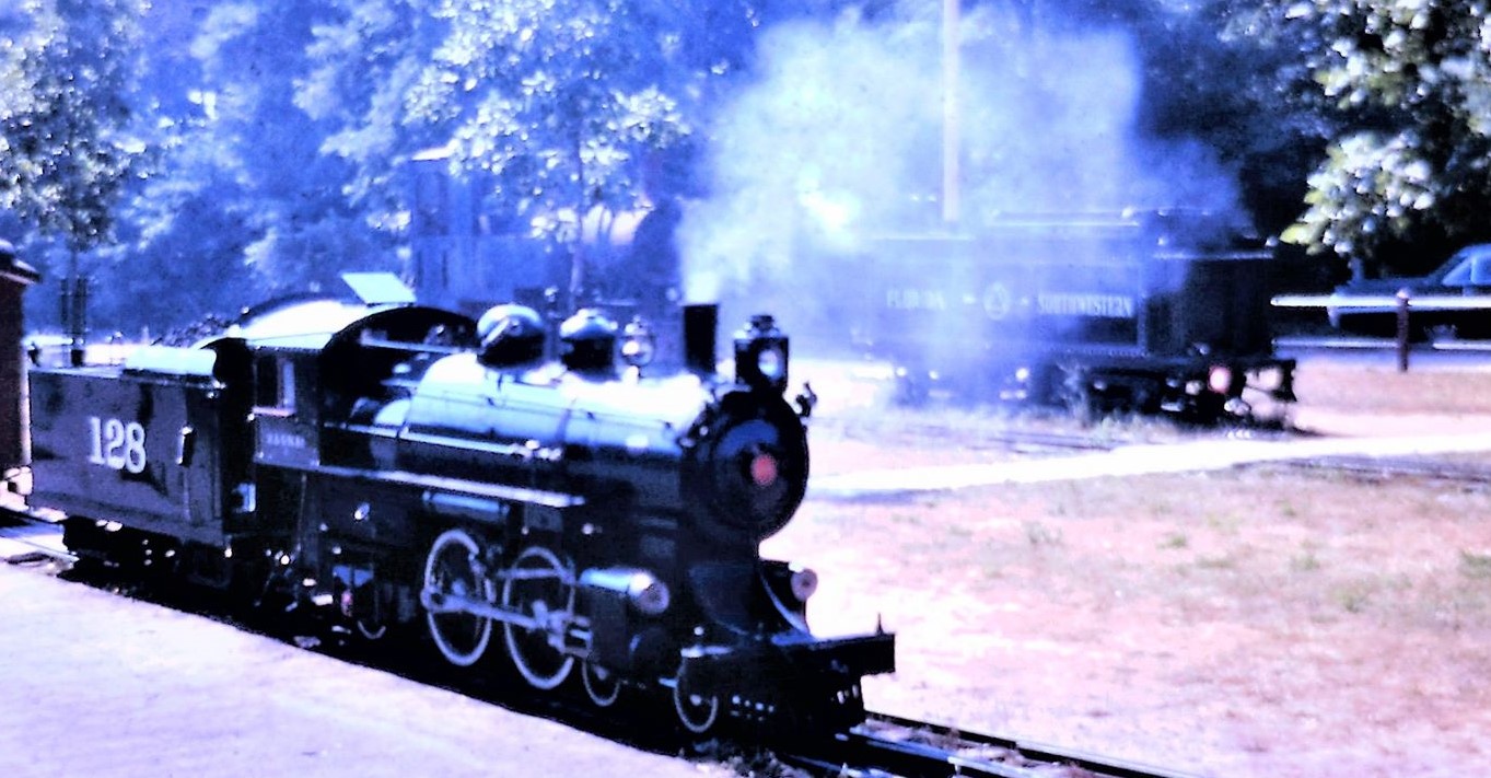

The photo below taken in the late 1960's shows the locomotives tender sitting at Sandley Light Railway Works (see in the background). I have been told the tender and the locomotives frame/drivers were sent to Sandley to have a new boiler constructed. This work never occured and the engine disappeared from Sandley sometime in late 1969 or early 1970.
https://donsdepot.donrossgroup.net/dr0703/md001.jpg
The trail goes cold at that point and the engine just seems to disappear. The Hesston Museum doesn't appear to know anything about it although they do have a 24" gauge speeder that came from the Florida Southwestern in their collection.

These look like two different engines. Where did the extra driver go in the second image?

Opps. Not the locomotive the thing in the back ground. I should read a little more crefully.

The second photo is captioned "Riverside and Great Northern", there is a preservation group which maintains this 15" line, the old Sandley operation in Wisconsin Dells WI: https://dellstrain.com/museum-history/ I couldn't find a mention of your locomotive but the group might know what happened to it.

I contacted a person from the Riverside and Great Northern group, who forwarded this photo, along with a report from a former Sandley employee who was there at the time the Pacific arrived:
"[I]n addition to the photos in the post you linked to, we have the photo below (tender and engine behind 128) and this comment by one of our former employees who was at the Sandley Works at the time the locomotive was there...:
"All I know about it for sure is that it arrived about the same time as the two German engines Elliott wanted us to fix up for Brookfield Zoo. [A certain employee] wasn't into 'fixing' stuff up, so he conned Elliott into butchering the Brigadelok into a 2-8-0 tender engine, and then building the entirely new 2-4-2. The 0-4-0T German engine went to Heritage Square in Golden, Colo., but I've no idea where the Pacific went. By the time I saw it, the boiler and 'sheet metal' was gone, and it was just a bare chassis."'
