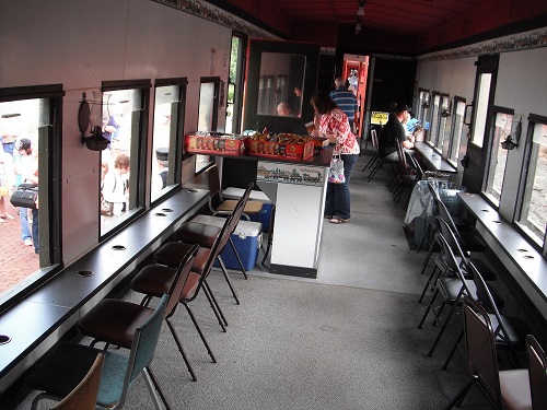

the Little River Railroad in Michigan has a troop sleeper that is used as a refreshment car in excursion service. The floor is covered in some kind of loose industrial flooring but the tile might still be intact underneath. You might want to ask them.

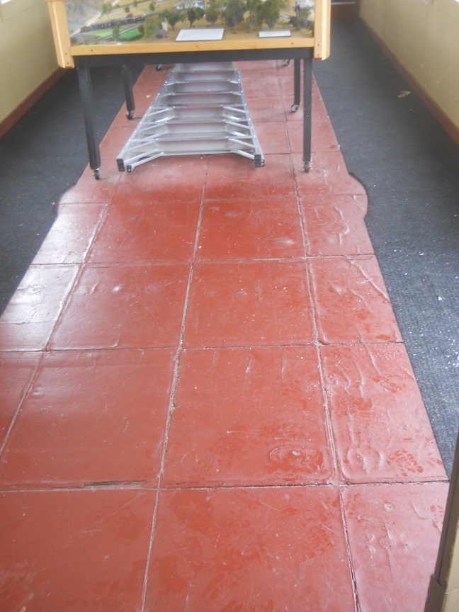

Here is a shot of the rubber tile floor that Pullman put in the Troop Sleeper located here at the Hoosier Valley Railroad Museum in North Judson, Indiana. For part of its existence, the car had a false floor installed over these tiles by the Wabash (or the N&W) when the car was put into company service. But when we removed that false floor a number of years ago, we decided to keep the Pullman tile. For its age, it is still in remarkably good condition.
