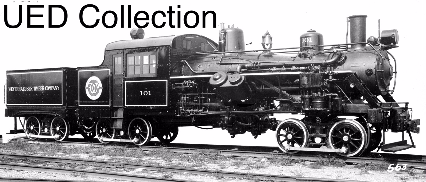

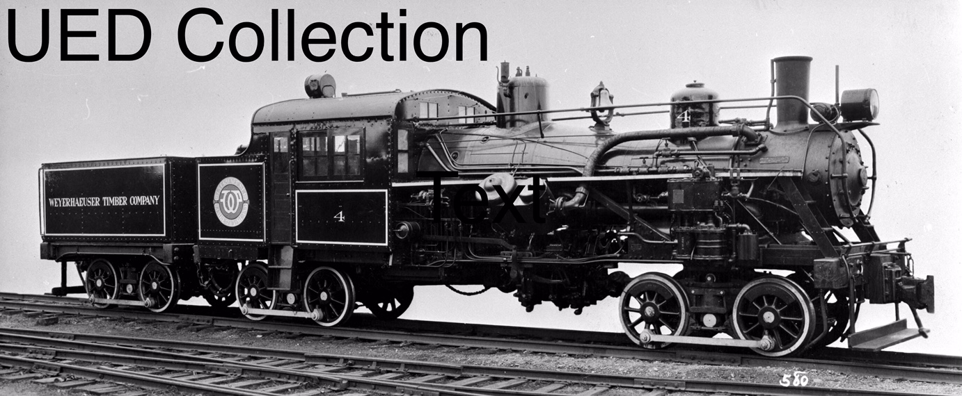

For info here the 3 configurations they build.
1. superheated, outsite steam admission piston valves, open cab
february 1926 - early 1928
2. superheated, outside steam admission piston valves, all weather cab
early 1928 - late 1928
3. superheated, inside steam admission piston valves, all weather cab
late 1928 - 1930 (five build for stock delivered 1936, 1939 and 1941)
 Post subject: Re: West Coast Special Heisler; when and where come the term
PostPosted: Thu Jul 16, 2020 9:23 am
Posts: 1270
The term "West Coast Special" was coined by Heisler. The first use I can find is an ad from July 1928 stating that they were available in 70, 80 and 90 tons. The Class 90-12-40 was 110 tons in working order. The first 3 WCS were 90 tonners sent to Weyerhauser at Longview, Vail and Melbourne, WA.
PostPosted: Thu Jul 16, 2020 10:24 am
Posts: 268
Thank you John,
in what periodical or newspaper you find that ad?
Did they mention the lower gearing/enhanced tractive power?
Is it possible you post or send a copy or photo of that ad? Would be great.
The engines you mentioned:
The one goes to Longview, WA is the 101 in the picture above June 1928.
The Vail, WA loco is the number 4 above November 1928.

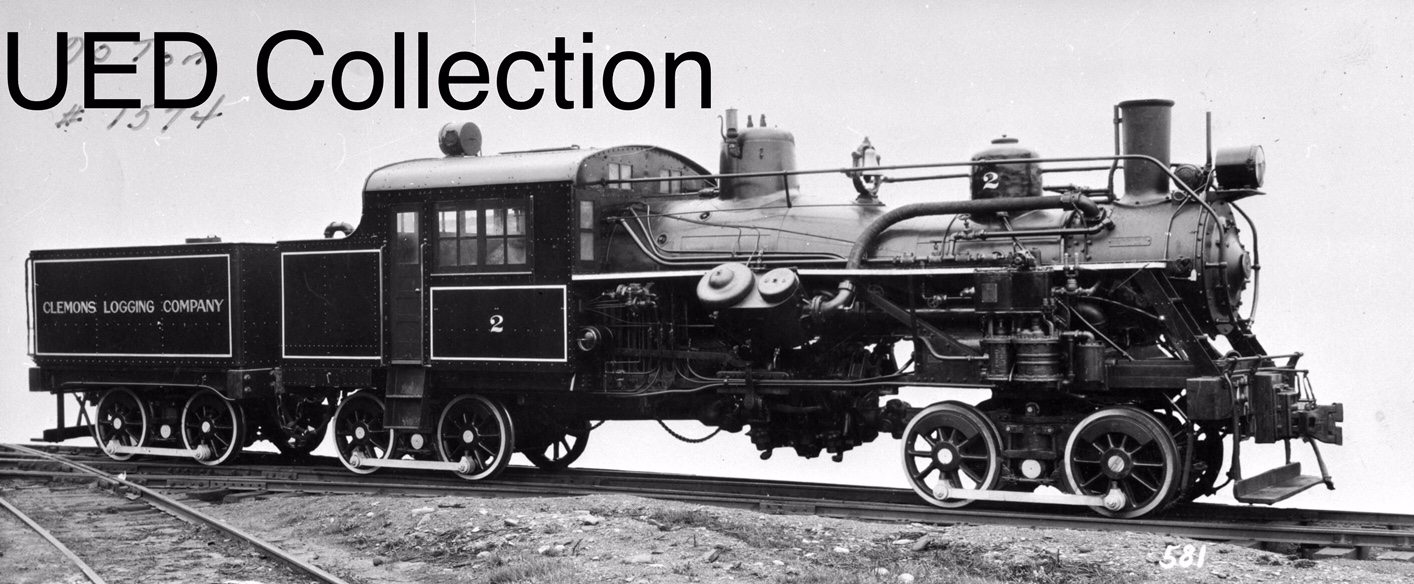

That Melbourne, WA engine goes actual to Weyerhaeuser subsidiary
Clemons Logging in November 1928. See pic below.

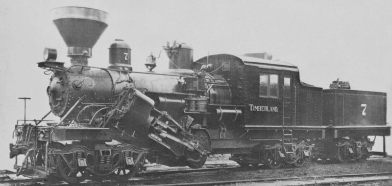

No,
neither Heisler or Climax build engines large like the WM6 150-3 Shay.
The largest Heisler was the 90-12-40 class (all pics above) with 43600lbs TE.
Climax build two 100tonners class C-100 with 44000lbs TE as their largest
locomotive (see pic below).
The phrase "modern" for WM6 is... let say not anybody would agree...
Actual the 1945 build monster is a copy of the 1921 G.C.&E. RR #12
plus improved girder frame and piston valves instead of slide valves
delivering 59000lbs TE (same like the engine 24 years before).
And it is not the biggest Shay at all.
Kansas City Southern received the only 160-3 class in 1913 powering 74000lbs TE.
