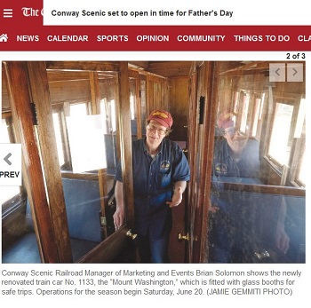

Thread on the Ahead of the Torch (AOTT) website showing their heavyweight open window coach # 1133 (ex-CNJ) with compartments ala British Railways. Access through center aisle. Each compartment seating up to 4 folks. Wonderful craftsmanship, and a way to deal with "social distancing." Wonder if in the future, this might be the way to go? Certainly a way to deal with the "problem" right now!

File comment: Photo from Conway Daily Sun via the internet
Conway Scenic set to open in time for Father s Day Local Business News conwaydailysun.com - Copy.jpg # 3.jpg
Conway Scenic set to open in time for Father s Day Local Business News conwaydailysun.com - Copy.jpg # 3.jpg [ 78.04 KiB | Viewed 20238 times ]
Hi all
Here is a photo of the coach # 1133 taken by the local newspaper the Conway Daily Sun, Pat .
