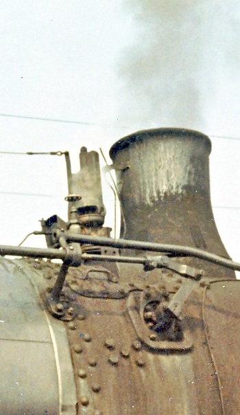

The unique sounding whistle 1246 wore for much of if not all of it's career in Bellows Falls was a Boston & Maine 5 or 6 chime. Images will show that it's noticeably longer than the standard CPR whistle and had B&M cast in the chime. I'll try to scan up a picture and post at some point soon.
Bill D

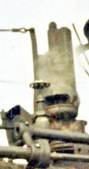

Hi Bill
You are correct for what you did post, Yes she did carry a B&M freight a 5 chime whistle and a 6 chime passenger whistles from time to time.
She also did carry the whistle off of GTW 6039, also, for what I can remember. the whistle off # 6039 also stood tall like the B&M whistles.
I don't know what year the CD was made, but if it was before 1973, the Green Mountain RR still owned CPR 1246 and 1293, they were sold to Steamtown July 1973.
Here is a photo that I cropped of # 1246 when the Green Mountain RR owned her, I cropped the whistle, and the whistle looks like a B&M 6 chime.
