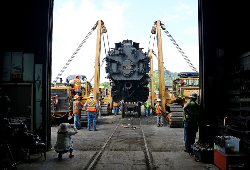

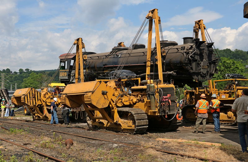

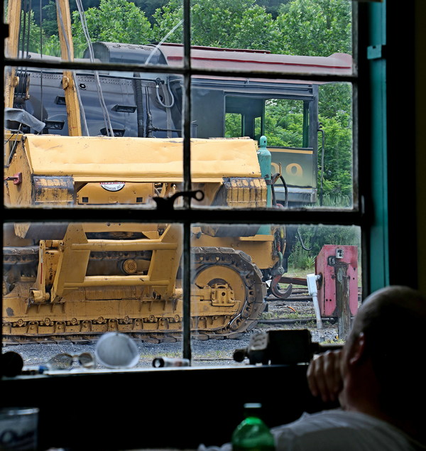

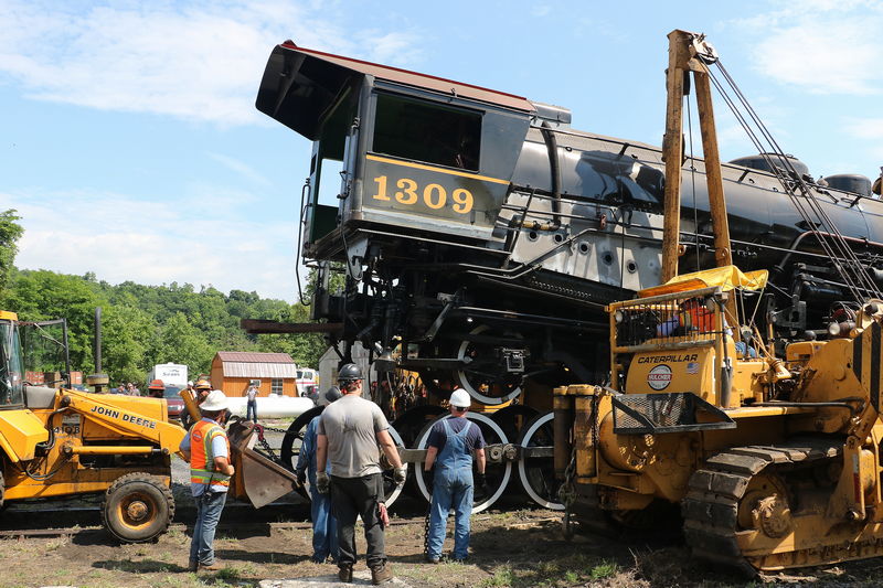

Some photos from the Re-wheeling of Western Maryland Scenic Railroad #1309 yesterday at their shop in Ridgeley, WV.
Tim W.

Good to see, though: Hulcher = a pretty penny. Bit surprised they didn't work on some of the cosmetic stuff like painting the boiler jacket while they were waiting for funds to replace the stolen driver boxes, though that might not have been possible with it up in the air.

I didn't take a lot of pictures when I was there last spring, but I think it was already painted and what your seeing is dust. Hulchers Vultures were not there last spring when I was and it was on the ground. Seriously though I think your looking at dust. The loco has been sitting for some time so a simple wipe down and she will look very nice.
I for one am glad to see the wheels finally under it again. I also hope to see her run. Am hopeful the rest of assembly goes pretty fast as much of it was already done last spring. I recall a lot of negativity directed at the UP during the Big Boy restoration and then UP was the hero for doing it. Same here. I hope once this is running the negativity and picking of nits stops. Congrats to the crew for getting past this milestone of getting the wheels mounted. Once broke in this loco should run for a long time. They have not skimped on workmanship that I could see. So in the immortal words of Charlie Berens, "keep er moving". Regards, John.

That second picture, front view shot makes the wheelsets look almost too narrow for that massive boiler!
Judging from the shadows, the boiler appears to be closer to the camera than the wheelsets, but I thought it was a very interesting perspective.

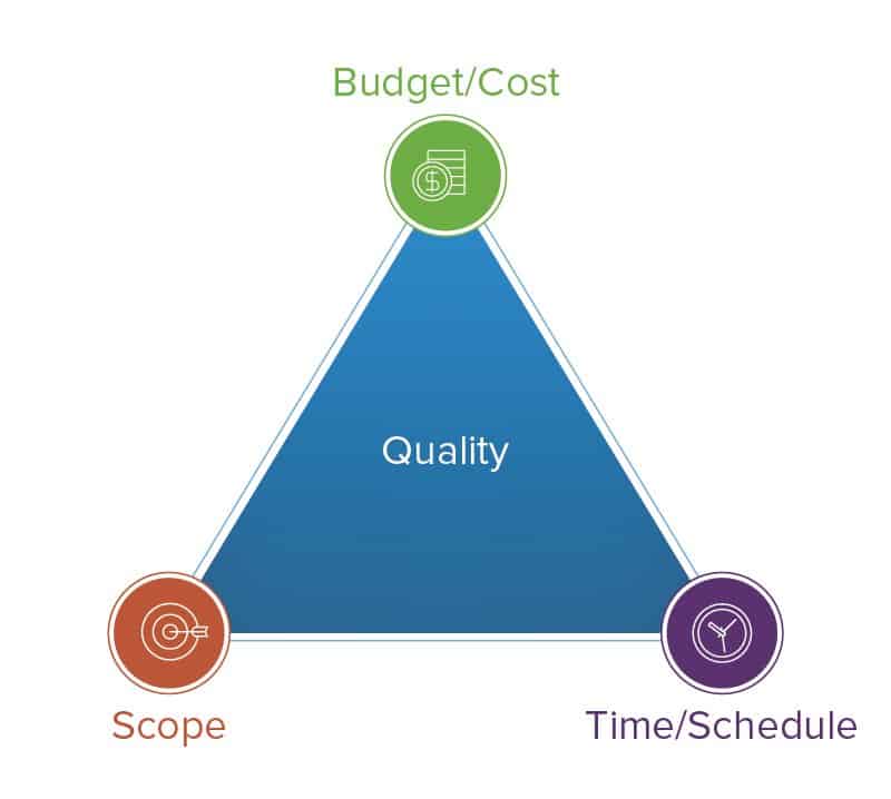

From what I'm told, these guys (and any heavy equipment outfit like it) are a LOT cheaper IF you work around THEIR schedules and availability, not say "we need you right away."
Looks like you just took away one of the legs of the Cheap, Fast, and Accurate triangle.. In this case, this is project management... So, remove the "Time/Schedule" and you've nailed down two benchmarks of the triangle :)
