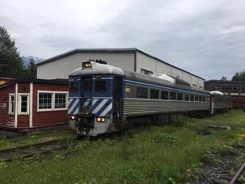

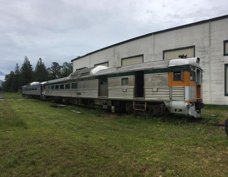

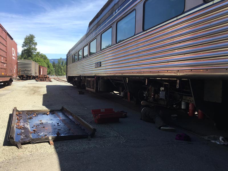

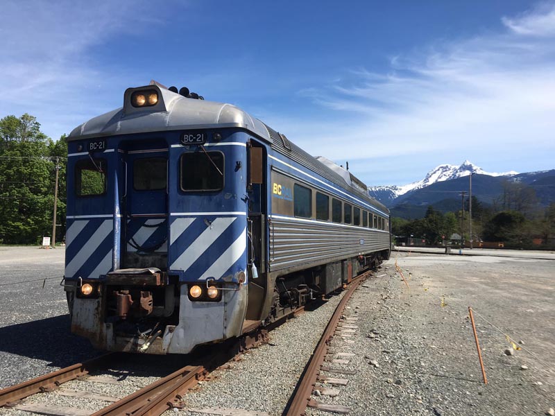

While this project has been on and of for the better part of 2+ years after sitting un-used since 2012 a few of us have decided to tackle the remaining items on BC-21 to get her running better and more reliably. Previously she had been running on one motor that would decide to shut down after an hour or so of use. Over the past month we have been troubleshooting the front motor not loading after commanding it to do so, after swapping out the fuel pump with a spare in the shop, checking and replacing solenoids, cleaning out lines it all came back to the pump. After taking pressure readings that showed there was something wrong with the pump we had decided to take the working pump from the working motor and placing it to the troubled engine, sure enough there were no problems and it ran like a top! We were able to take another spare pump and add it to the rear motor with no problems as well, its always good to have a small little victory in 2020!
