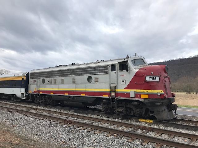

File comment: 1755 at Romney, WV 3-19-2020
1755 at Romney WV March 19, 2020

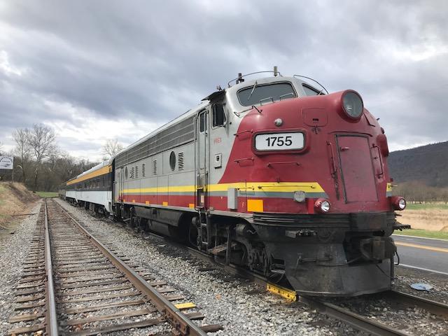

1755 at Romney, WV March 19, 2020

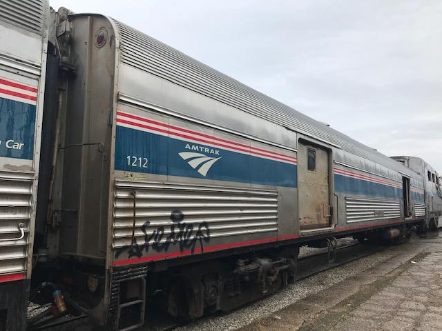

I believe the 1212 and the 1162 were originally Santa Fe built in 1953. I took these at Beech Grove on December 14, 2019.

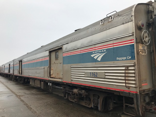

1162 at Beech Grove 12-14-2019.

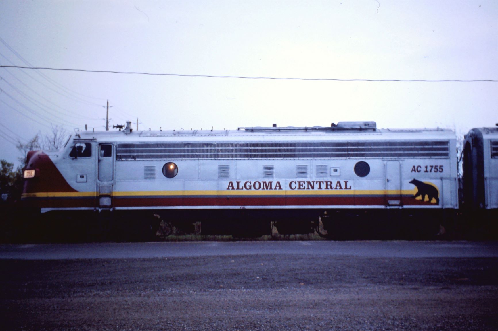

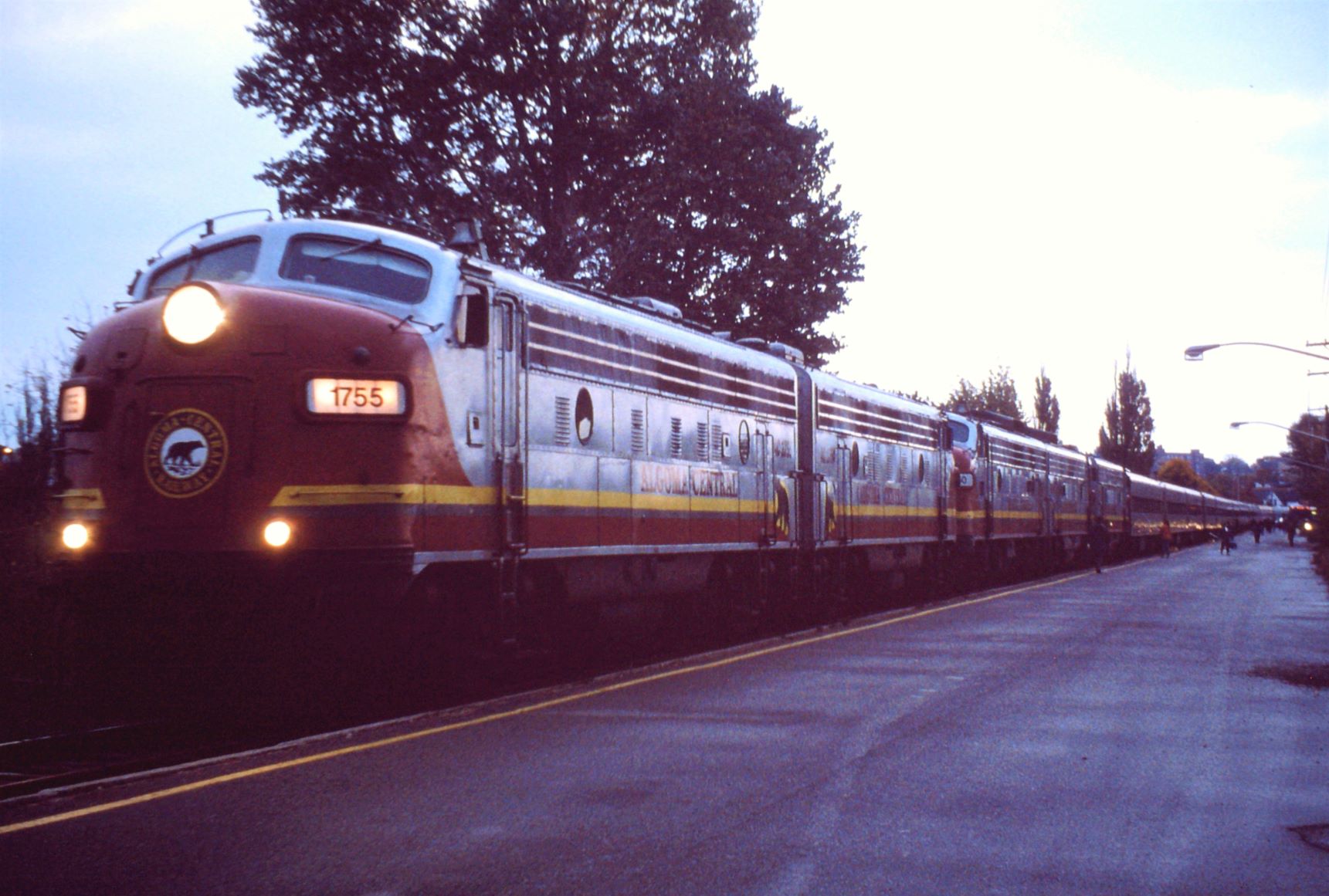

A couple of photos of 1755 taken on a very gloomy morning in Sault St Marie, ON, during October 1997....
