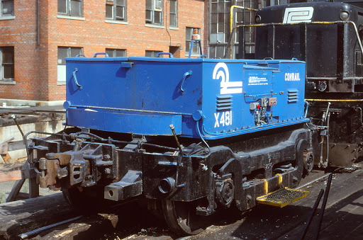

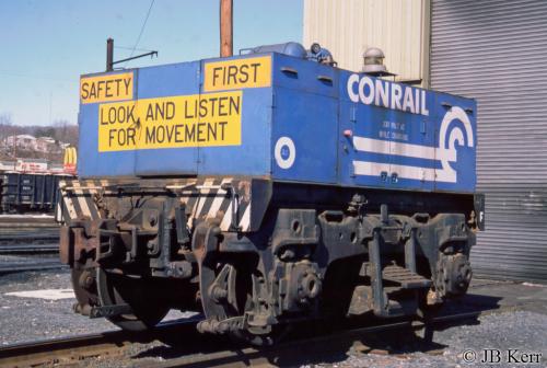

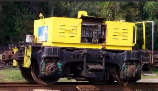

0 is still working the Enola wheel shop.

Nice of them to reuse front coupler pockets from steam locomotives. The top one even has a split knuckle coupler! It would be interesting to know what locomotives those came off of.
Is it possible they may have come from tenders? At least some tenders had solid pockets like this, and I think the odds of a tender hanging around would be greater than for a locomotive.
Either way, it's still amazing to see something like this being reused today, complete with a slotted knuckle!!

On my visits to the Reading Railroad Heritage Museum in Hamburg, PA, during the yard tour, there was what appeared to be one of these “bug” shop switchers. It still had rather faded Conrail blue with the well known “CR” mark from the early days covered up on the sides. In addition, also partially covered and faded away, was the unmistakable disco stripe logo of NJ Transit.
I’ve also come across, although I don’t remember where at the moment, a photo of this unit on the old CNJ transfer table at Elizabethport in the 1980s with the NJT stripe fully intact.
Is this one of the bugs previously described, or is this one another unit?

"I assume that the bugs were powered by batteries, and were radio controlled?"
Batteries Yes.
The first unit X 481 has a yellow platform hanging off the bottom of the truck equalizer bar. And some controls on the side of battery compartment, forward/reverse/throttle ?
Talk about an "open air cab"....

The yellow one was donated to a group in New Castle, PA and later on sold to Truck Electric. I last saw the remains of it at their facility in McDonald, OH.

The 'Bugs" were used to spot locomotives on the underfloor wheel machines. The controls were mounted on the side. There was a small one lung air compressor driven by a DC fuel pump motor for straight air brakes. I seem to recall one having the controls on a tether which made it easier for one man to make a spot.

Pretty sure I saw CR X481 sitting behind the shop at Steamtown when I was a kid. I asked what it was, and they told me it was a battery powered Alco truck.
