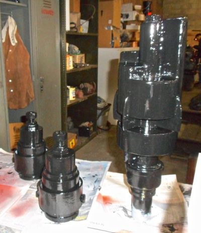

A consideration is do you have surplus manpower to replace the parts on the donor locomotive with the unusable parts? Or would the time be better invested on other equipment?
For our USATC Consolidation we were permitted to remove some parts from an identical display locomotive in a park. Our philosophy was that we wanted to respect the donor locomotive and make it look complete and also show appreciation to the government unit responsible for it. (The caretakers of the donor locomotive referred to it as an organ donor.) We fabricated a replacement whistle, injector, safety valves, buffer, and power reverse to replace items that had been long missing, were needed for our overhaul, or that we could use for spares. We believe the extra work was a good investment.
File comment: These fabricated "replicas" replace parts that disappeared from the park display locomotive over 50 years ago.

How did you make them? Metal or epoxy? Rubber moulds?
They look good, good enough for a static display loco.
 Post subject: Re: Peserveing the parts unit.
PostPosted: Wed Apr 08, 2020 3:16 am
Posts: 704
Location: Anchorage, Alaska
Weldments from pieces of plate, pipe, and tubing.
