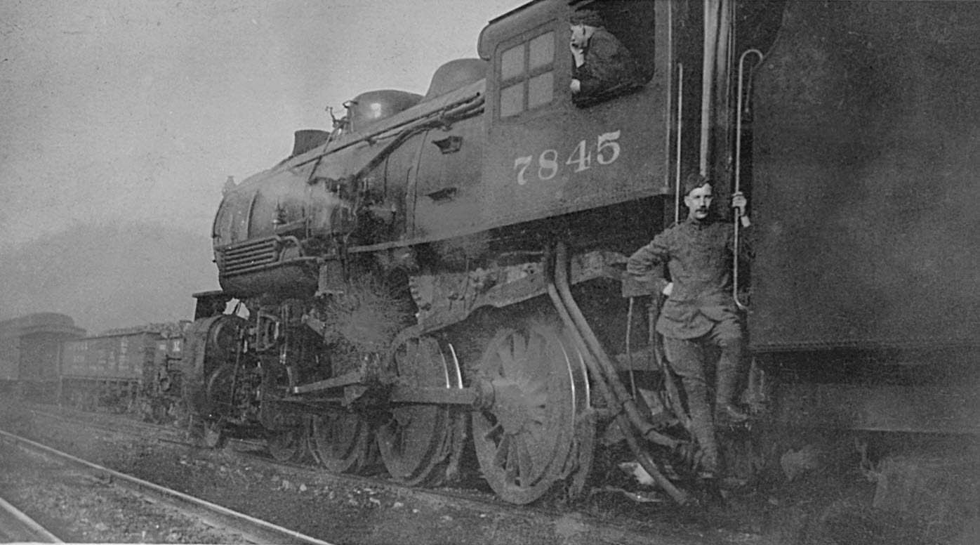

Looking to identify the railway company that owned the 7845 in the photo. Any information as to locomotive class or other pertinent information would be much appreciated. Era of photograph is believed to be WW1.

My hunch was NYC looking at the locomotive. I would assume these to be the same but with a later renumbering. Was originally numbered based on subsidiary company. Those versed more in NYC roster can probably point you better.
https://www.railarchive.net/nyccollection/nyc1162.htm
http://rr-fallenflags.org/nyc/nyc-s1154s.jpg

Definitely NYC Lines. G-46 or similar class 2-8-0, possibly a P&LE engine.

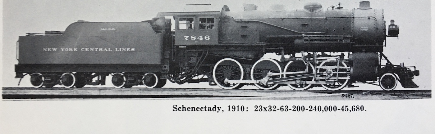

Looks like a Michigan Central locomotive, possibly G6 class. I found MCRR 7846 in Alvin F. Staufer's "New York Central's Early Power Vol. II" page 298. Sorry it's one number off!

Thanks to Howard P and SR6900 for pointing me in the right direction, now here is your answer
As Howard & SR 6900 said the locomotive is New York Central, here what I have for information on the locomotive.
The engine is Michigan Central, Class G6o cyl 23+32 drivers 63" boiler pressure 200 psi. The locomotive was built by Alco as MC # 7845, renumbered in 1936 to #995 Renumbered again in 1948 to #1129.
Alco builder # 47265, Build May 1910 Retired June 1950 Scrapped the same date.
I found this information in the book Steam Locomotives of the New York Central Lines by William D. Edison and H.V. Vail Jr.
The book was produced by the New York Central System Historical Society in 2002.

The uniform is the model 1917 wool uniform for US soldiers. He's wearing the spiral leggings, and the Eastern European patterned side cap. That would place the uniform from 1918 to well until the 1920s.

I doubt that as the parts of the uniform he's wearing wouldnt be commonly found in the US then. Those side caps started in Europe and before the armistice, you'd mostly find soldiers wearing web leggings and campaign ("Smokey bear" type) hats.

This has me wondering. Weren't there instances (albeit brief) in the post-1917 period when strikes against the railroads were addressed with some kind of Government intervention?
That person on the tender steps is not likely a railroader, with that stance and those shoes...
I had the same thought when I first saw the photo, "something's wrong here." It almost looks posed with actors.

PMC - I figured it was just a soldier getting his photo taken by a friend using a rudimentary World War 1 type camera. Fireman is obviously waiting for the road to clear ahead. When the signal clears, the 2-8-0 will be off, and the soldier will step down from the steps. He's probably not involved with the engine (or train) at all.
BTW, can anyone make out the railroad initials on the drop-bottom gondola over on the next track?

Those that have expressed ideas that this is probably not a uniform from the USA are more than likely correct as this we believe is a British uniform. Perhaps this photo was taken on Michigan Central lines in Ontario, Canada? We could not confirm this as a plausibility until the knowledgeable contributors identified this as a Michigan Central locomotive, something that we had difficulty in doing. The British military I understand, did have a presence in Canada during the first world war facilitating military training and organisation.
A descendant of the soldier in the photograph has always wondered where this was taken, which railway was represented and what locomotive type this was. He by the way, is an ardent railway enthusiast and preservation supporter today in the UK.
