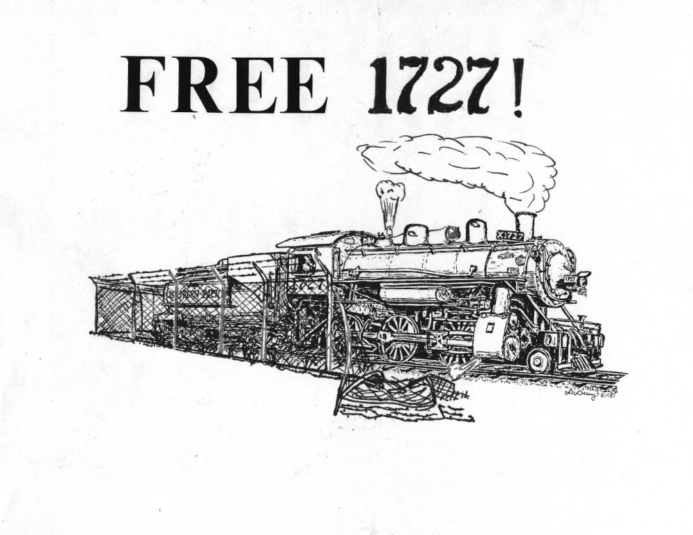

1744 is an excellent choice for them, and a worthy class of SP power to see preserved operational. I just wish they'd gotten 1727.
Steamcerely,
David Dewey

On SP1727, visually things look good. The driver tires are not dished, and appear to be pretty thick, the main rod brass wedge is barely off its heel; what we can see of the boiler looks solid and it held 120 pounds water pressure in '78. Also, until fairly recently the summer sun on the air reservoirs would build up air pressure in the tanks. In 1978 all the accessories would operate with 120 lbs of air (after the hydro, we lowered the water to normal level and tested everything and lubed everything as well as tried to cap off any openings that might let water into where it shouldn't be. After all the "fun" we drained the boiler and left the corner and belly plugs out for a long time to give the boiler time to dry out. Since the whistle was cut of a few years ago, that opening has been wide open tough (they sawed the brass elbow in half to get the whistle), as has the bell ringer air line.
When Portola RR Museum moved the SP1215 we found lots of signs that it had been shopped, and not run much, the main cylinders still had machining marks in them, there were chalked notes on the main boxes, yet some of the valve gear had noticeable wear. It was interesting that when we pulled the piston covers off, the insides were nearly pristine, almost no rust at all--steam cylinder oil sticks for a long time! We sprayed lube into the cylinders and when we went to move her, she rolled very nicely. (we had lifted the boxes and polished the axles first--there was just a little rust between where the grease cake ended and the brasses began. When the San Jose group gets around to the 1215, they should find some good bearings under her, although the Museum folks did move her around a LOT more than I would have liked.
Steamcerely,
