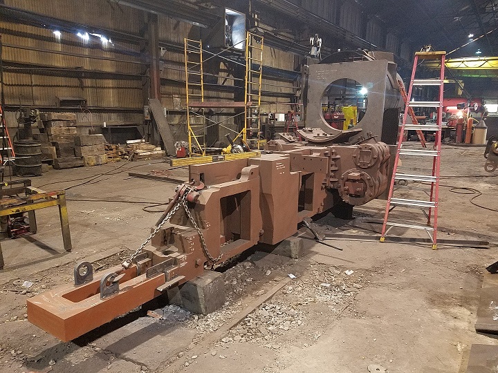

Reichard Industries, successor to the William B. Pollock Co. and the only domestic builder of hot metal cars, has begun doing some welding work on the J&L 58 frame. Their task is to weld the front plate onto the frame as well as attach a rear frame extension. This heavy welding is beyond my abilities to do and Reichard volunteered to donate this work, which we are immensely grateful to them for.
After this work is completed and the ice at the museum melts, the frame will be returned and placed back onto the drivers. Then the real fun begins!
The Reichard plant was originally the Youngstown Car Company, an early 20th century builder of freight cars. In the background a new barrel for a bottle type hot metal car is being fabricated.

Is that frame extension a casting? Machined from a chunk of steel? Fabbed up and machined?
That is a fascinating little engine. I love seeing your progress reports and it truly looks like you guys have a good thing going. Whish I was closer so I could offer assistance. Porter, Vulcan, and other small engines always appealed more to me than their main line cousins.

EWrice, the rear frame section is 6" thick plate burnout. About the only castings used on 58 are the cylinders and the cannon boxes. Everything else was made of steel plate.
Thanks for the compliments! Hopefully you can visit sometime we are running the 58 and go for a ride with us.

One thing that stands out in the photo of the setup to rebuild No. 58's rear frame is that it looks like things are being prepared for thermite welding. There's certainly a gap in there, an apparently a quite deliberate one!
I wonder what the people at the shop have said about working on this engine. Although the techniques are undoubtedly pretty standard, I bet they've never worked on a steam locomotive before!

The gap you see is where the ends have been beveled for welding. Welds will be approx and inch deep all around. I originally considered thermite welding that joint when I was going to do it back at the museum, but its unneccesary because the only stress this joint sees is the weight of the rear platform. Draft and buff forces go through the drawbar which attaches ahead of this frame extension.
