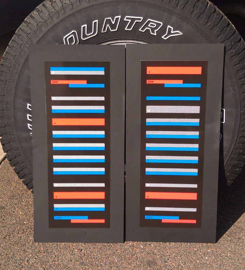

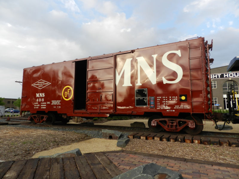

We did a 1970s era restoration of a Minnesota Northfield & Southern boxcar and caboose several years ago and made up replacement barcodes for them that were then simply printed on an outdoor vinyl. (Sans-reflective properties, as we were on a budget...) But the end result turned out very nice. See pictures included.
To build the barcodes, I seem to remember considering future planning, and writing a web-based PHP script to take user input and then simply assemble the bar images in the correct order (yes, even with the correct check digit) as a single graphic that I then sent off to our local sign shop. Using Eric Neubauer's document on the subject (http://eaneubauer.ipower.com/aci.pdf) helps out in finding the correct railroad code. That was a couple of computers ago. I'll have to see if I have it backed up somewhere since we have yet to do any other ACI-era restorations. (Well, it was such a narrow span of time they were used...)

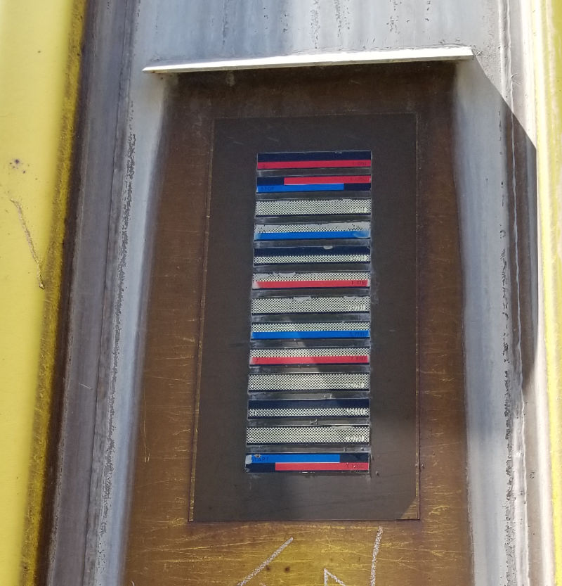

At our railcar shop, we are still occasionally getting 1970s-built hoppers that still have these stuck on. Third picture shows one that, all things considered, is in pretty decent condition. Note the little protector that was welded on to shield it from spilled commodity.
Rivet-counters will notice a slight difference in the STOP codes of my reproduction label and the PTLX label. Mine was based off the original barcode that was on MNS 408, so it appears that there were adjustments or variations in the specifications even when the system was in use.

File comment: KarTrak ACI tags for MN&S Boxcar and Caboose. Boxcar is on left, caboose on right.
File comment: MNS 408 as restored by WRC in 2013. Car was repainted to renew its in-service appearance from the early 1970s. Placement and size of all elements was measured off car before repainting began. The stencils and marks applied illustrate various changes in mechanical and reporting requirements during this era.
File comment: ACI Barcode on PTLX 17801 is still very readable... At least to human eyes. Photo taken July 2019 - Shoshoni, WY.
