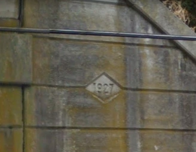

From the 1920s through the 1950s, RDG would cast the year of the bridge's construction in one of the abutment walls as shown in the attached photo. When I was there in the '70s, the steel forms and changeable digits for forming these date stamps were still stored in the blueprint room on the 13th Floor of Reading Terminal. I probably could have saved a sample after ConRail took over but alas didn't think of it at the time. Plus, the diamond-shaped plaque, being about two feet by 18 inches, might have been just a bit too heavy to carry home on the Crestmont Express....

Thanks for your input. Interesting that the Reading had cast iron bridge number markers. The embossed concrete bridge sign mentioned on the CB&Q used a decimal point for the bridge location (30.52) whereas the Reading apparently used the "fraction type" nomenclature as you explained. Either the Reading's method or the Burlington Route's would probably have lasted a lot longer than just the painting of the mileage spot on the bridge itself. I know of at least that one surviving concrete post on the "Q", do any Reading cast iron bridge markers still exist? Either in place, or preserved as an artifact?
