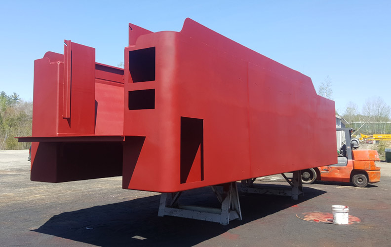

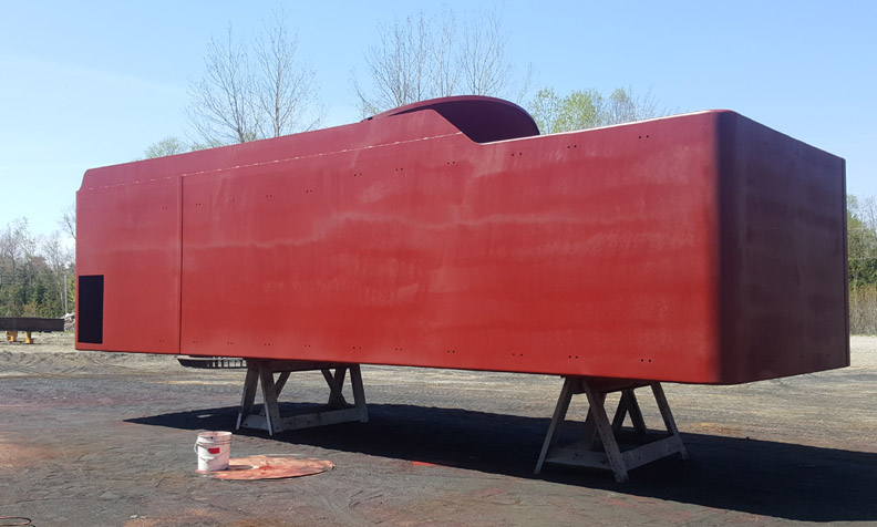

 Post subject: Re: Maine Central 470 replacement tender body on order.
PostPosted: Thu May 21, 2020 9:11 am
Maine Central 470's replacement tender will be delivered to the restoration site on May 22. The tender body has been fabricated by Millinocket Fabrication and Machine, of Millinocket, Maine. The tender body is welded around the seams but will be riveted in the traditional manner to reinforce the framework and maintain historic technology.
Coal gates, doors, grab irons, steps and ladders from the original will be reused on this body.
Two weeks ago Copia Specialty contractors of Bangor, sand blasted and primed the original 14 ton cast frame.
The original tender trucks are being completed inside the shop at this time and assembly will continue through 2020, and possibly into 2021.
File comment: Tender body primed for delivery A
May 20, 2020

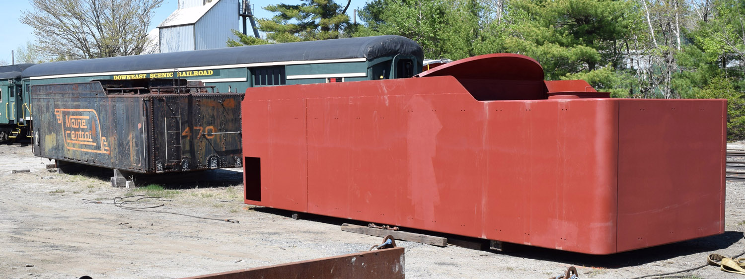

PostPosted: Mon May 25, 2020 11:09 pm
The new 470 tender has arrived and presently sits outdoors while preparations are made to bring it indoors for hot riveting. The original tender frame has been sandblasted, primed and painted as well, in anticipation of the reassembly, hopefully later this year.
File comment: New tender and old sit outdoors.
