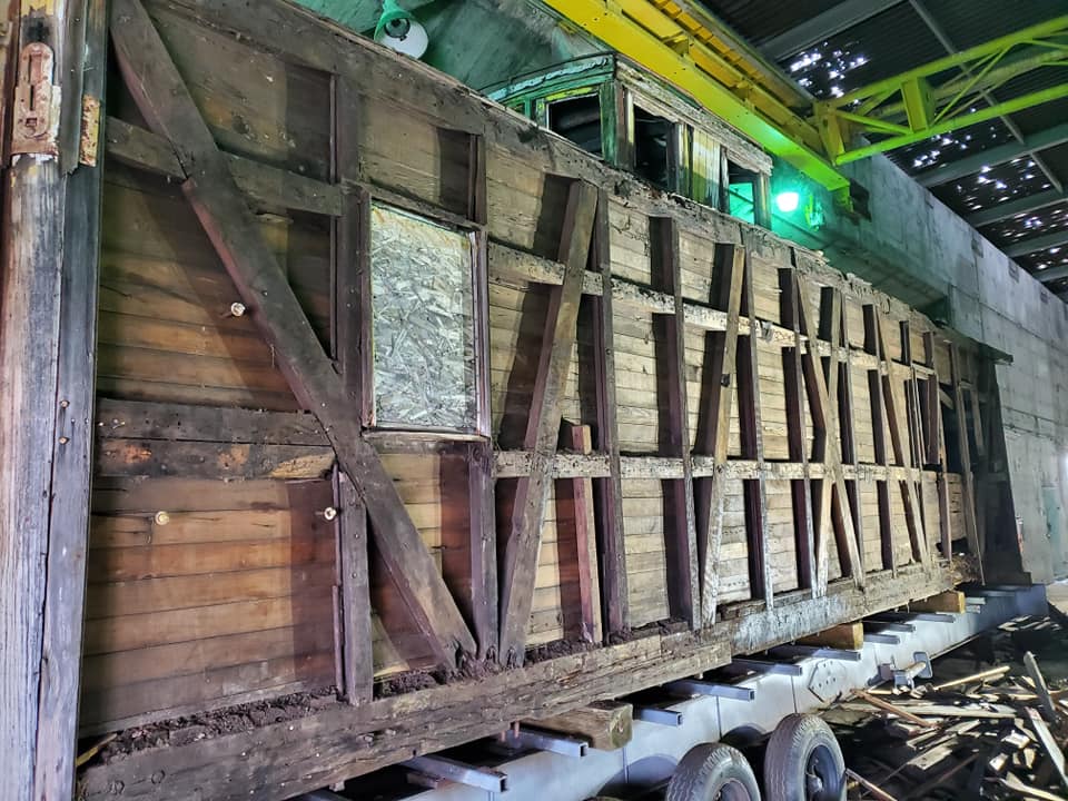

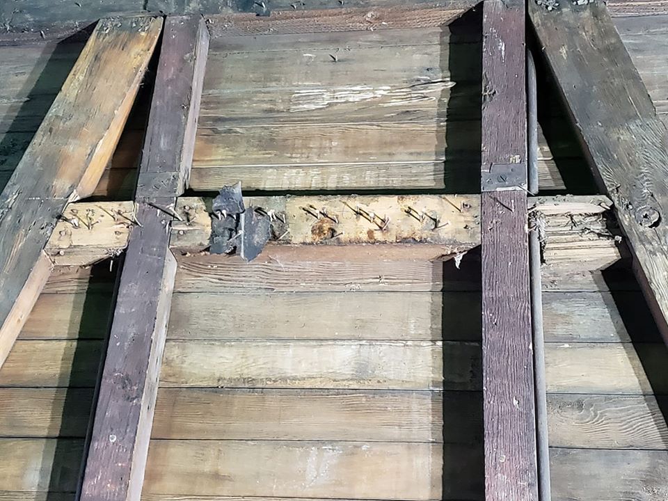

Today in Cheyenne on removal of the siding on our 1880 UP caboose 2095, we uncovered what we believe to be evidence of its former existence as 1150 a six window caboose with octagonal cupola from 1870, this has been shown to noted historians who so far agree with my detective work. 2095 was renumbered in 1885 from UP 1150 and has a build date of 1880, we believe that to be a RE build date from the earlier design. There is clear evidence of additional diagonal framing to the bodyside and oak uprights framing the 3 blocked up windows. cut off retaining strips above each window also add evidence. there are no plans or dating records for these cabooses except that photos show them from 1870 onwards until the NCS cabooses appear in 1880 with square narrow cupolas. Seems common sense to us that you would rebuild 10 year old cabooses rather than build new.

What are "retaining strips"?

Retaining strips are pieces of wood that ran across the top inside the window and allowed the window to lift up parallel with the body, thats what the two screws are holding in but the middle of the wood has been cut out.
The Cheyenne photo is 1890s so yes there were some octagonal cupola cabooses around then still but we dont believe in general service, at least no photos show them in actual train service by then. Most of these were rebuilt with regular narrow cupolas and then later lost more windows as well.

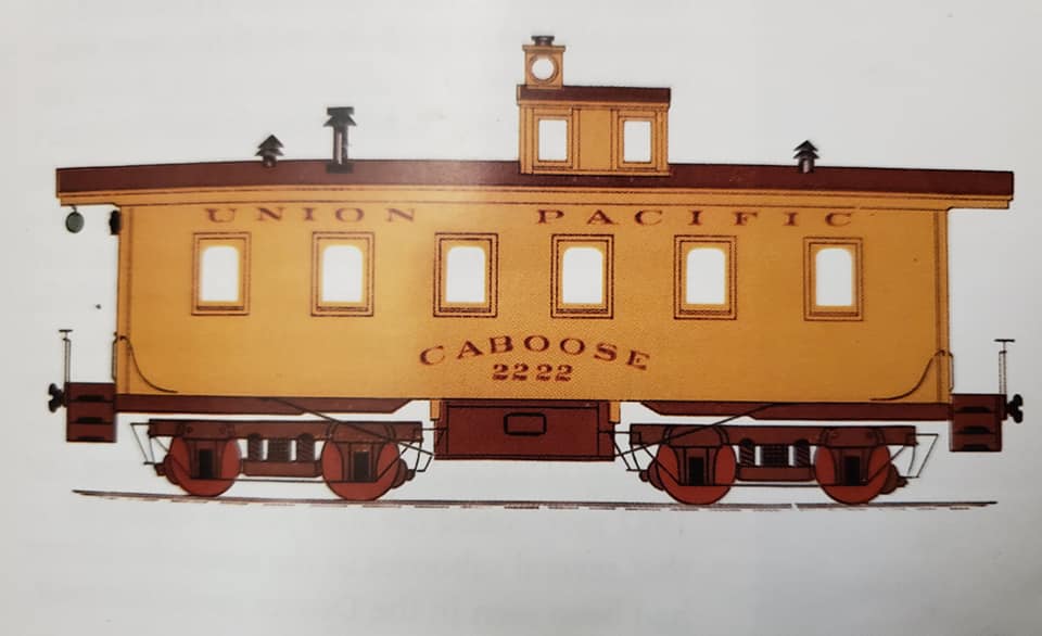

I know nothing about older UP caboose classes - Does the NCS class begin with 2096? Or did UP eventually lump all of the older cabeese into a single class of generally obsolete designs?
I notice your 2095 is not the same as the 2096 you posted on NGDF (or the assumed 20xx posted directly above it), the cupolas are different on the two 20xx versions on NGDF and the octagonal cupola job on NGDF post is a seven window. Plus a photo I have of a 201x is a six window with an entirely different style of rectangular cupola and horizontal siding. That's five variations, and three major distinctions, in just five units.
Do the historians know how many different types/builders there were of these many-windowed types?
A couple of down the road questions - If you restore this one to 1870s would you build a pair of the correct lighter short-wheelbase trucks for it as under the 1112? Arch top windows? And are those old paint schemes straw yellow? Lettering color looks like maybe a dark green with bottom left red shadow on the 201x. Sharp. Would be great to see an original style complete 1870s octagonal in living color. Keep up the good work. Wish I could help.
