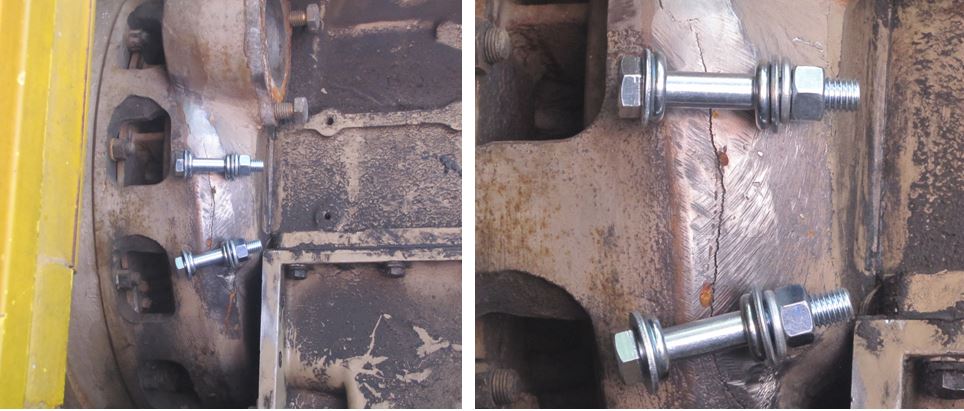

We have a 23 ton GE with an NHC-250 Cummins engine. The problem we ran into was the engine was not supported at the back except by a cast iron bell housing which cracked under the stress..

Attached are photos of out repair of the cracks on the right side.
