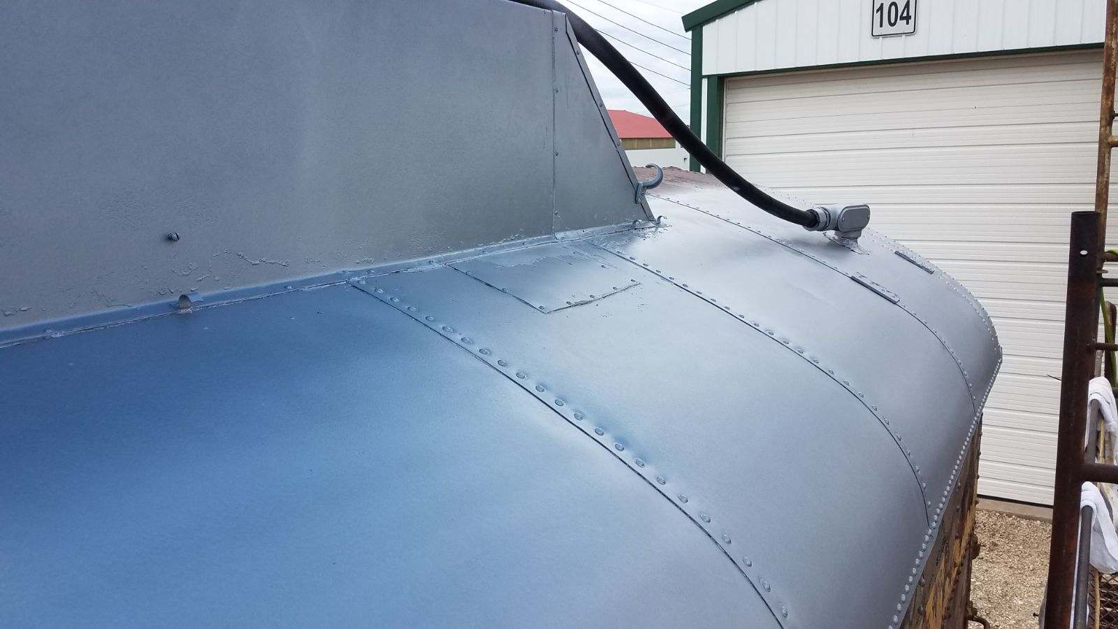

This permanent rust sealer will seal all your seems. Seal the area with this first especially if is a rusted area and apply your silicone caulk this car is being painted at IRM the product being used is Mastercoat primer/ sealer/ servicer. Rust bullet is a similar product. This particular type of coating will seal gas tanks that are pinholed inside and out. It's also good is a bonding agent for metal patches

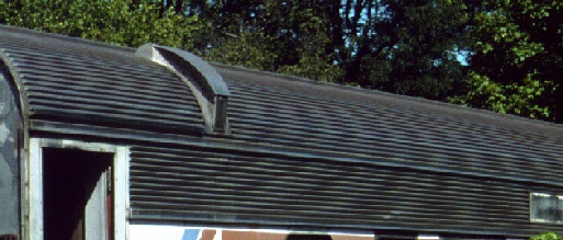

Has anyone ever sealed a fluted roof as shown in the image I include with this inquiry (which is very unlike the smooth roof pictured earlier in this thread) ?
My issue is a 1947 stainless Budd coach (ex-NYC). I need to spend more time on the roof, but I think my issue includes all the joints around that air vent.... the restroom under the vent is a mess w/ water damage while the rest of the car is not so bad except for issues around/due to the 'school bus windows' that previous owners installed.
Has anyone had to seal the seams on the fluted Budd roof?
Same ideas for sealants as noted earlier in this thread ?
Has anyone sealed seams and then sprayed an overall sealer on the whole fluted roof (as was noted for roof example earlier in this thread) ?
Has anyone ever had success applying a rubber roof over top of a fluted roof?
(I'm not trying to play dumb, just need to fix the problem with an eye towards 'really long term' if possible.).
Thank you very much!!
RayG.

Ray - Your car's roof is the same as ours, a typical Budd roof. So far, these are the options I'm considering pending research on suggestions by others:
1. Chasing individual leaks and sealing with Dow 1200 OS primer and 791 silicone (not your usual big box store stuff).
2. Going over the general leaking areas with an elastomeric paint-on rubber membrane, either tinted or paintable. Using compatible caulk or sealing tape at any gaps 1/8"+ prior to coating.
3. Coating the entire roof with #2 above and get any/all leaks at once.
Cleanliness is most important, i.e. remove all old caulk as best as possible to avoid dissimilar material degradation, and cleaning off any loose paint, dirt, oil/grease, etc.
You have to be careful with silicone sealants. Nothing else will really bond with it other than maybe silicone if you're lucky. And it's not compatible with most other types of sealants and gaskets. MEK is a good cleaner prior to using silicone. Acetone works almost as well. Use appropriate safety precautions.
Cost is a big factor in this project (isn't it always) and we'll have to make a determination of which way to go after a much closer inspection to get the best bang for the buck and considering the amount of long term maintenance for each system. The less you walk on the roof, even with tennis shoes, the less leaks you'll have to chase.
