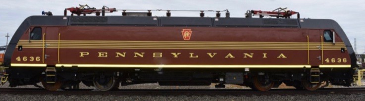

Also, here is a real-life permutation that I do not see in your graphic.
