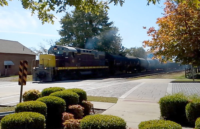

Judging by the blue cloud following this Arkansas & Missouri C420 going through Rogers AR last month emission regs do not apply here.
