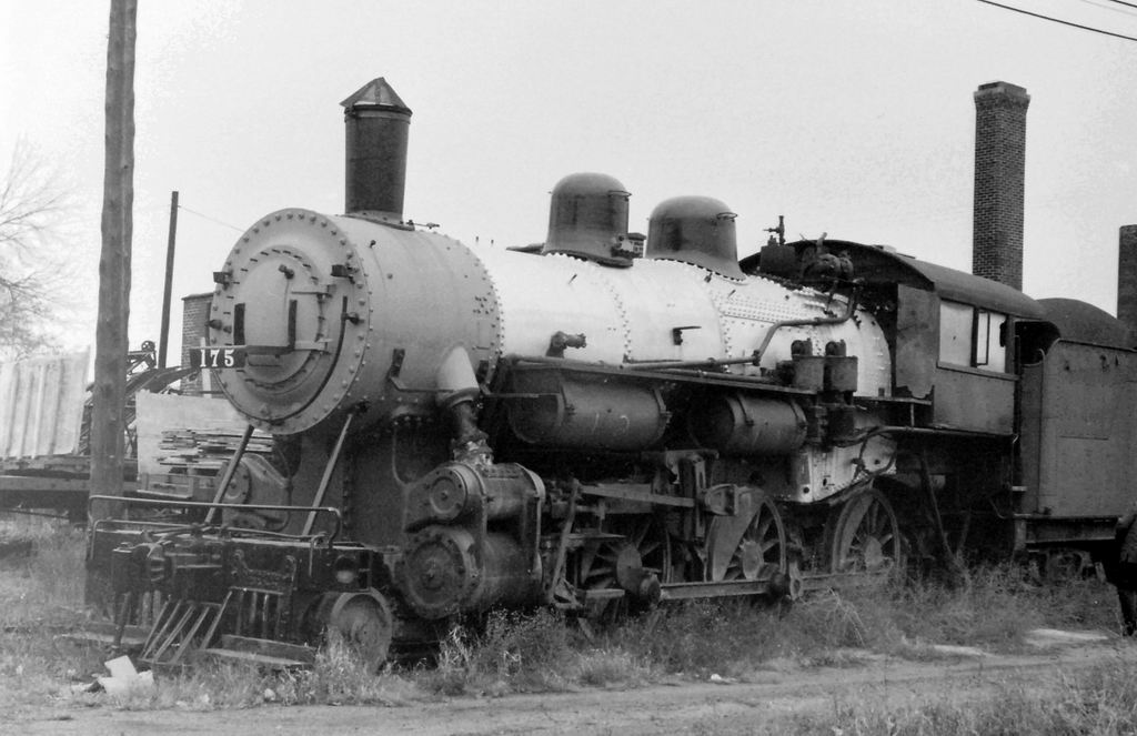

Do my eyes deceive me or does 175 have outside piston valves? Then also Walschaert valve gear?

Here you go.

The C&NW had 325 R-1s. They were built during the transition from slide valves to piston valves and thus have a variety of valve gear configurations. A few had traditional slide valves with Stephenson gear, some had inward tilted piston valves with Stephenson gear, like 1385 and some had the more usual Walshaerts configuration like the 175. An interesting class that served for so many years that nearly all were modified from "as built" to something different. How they ended up at the end of steam often had no relation to their "as built[" appearance..

As I write this I don't have the reference materials handy that we've accumulated for an eventual National Register nomination for C&NW 175, but I believe the last 20 R-1s had Walschaerts valve gear and outside-admission valves. Thanks are due the Chicago and North Western Historical Society for their publications and the Mid-continent Railway Historical Society for access to their drawing collection, which will let us get started on the 175.
Many parts have gone missing since the photo above was taken, and will be made from scratch, or scrounged. In some cases, it's no loss, such as the air reservoirs, which are typically not salvageable on an engine this old.
