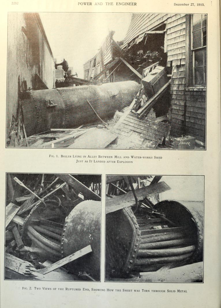

I'll bet these 1910 boiler explosion articles had the Hartford company's interest.

 Post subject: Re: The Locomotive Hartford Steam Boiler Inspection 1890
PostPosted: Thu Jul 16, 2020 7:48 pm
Posts: 237
Notice that they were ALL externally fired return flue boilers! The fire on the outside of the drum puts a lot more stress on the shell by causing a much greater expansion. In a locomotive type boiler the shell can only reach the temperature of the steam inside of it. Much less expansion stress.
