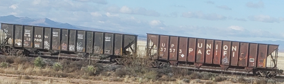

I go to California weekly on a run and recently noticed a long line of old coal cars on a siding at MM 22 in New Mexico in I 10. At first I thought it was a derailment, but the next time I passed there were more on the ground. I know these cars are newer, but a lot of them still carry road names of long forgotten railroads like DR&W, MP, and others. Has anyone reached out to UP to see about getting a few donated here and there for display? I know we wouldn't think to save cars like this, but some day down the road, future generations will ask why we didn't.
The ones I've mentioned were probably sold to a scrapper long ago, but UP may still have others that haven't yet been retired.
Just a thought.
PS, I tried to attach a picture of the cars, but it wouldn't upload. I'm sorry I can't identify them another way.

I've tried uploading the photo I took more than once. But I'm posting from my cell phone so resizing may not work. I'll pass them again on Thursday this next week and try to get some really shots then. My thought was more that they had been sold by UP to be scrapped.
As for the location, I'm having trouble finding it on Google earth. MM 22 on 10 drops you smack in the middle of Lordsburg, NM, but that's not where they are. I can't remember if they're east or west or Lordsburg either so it'll have to wait until Thursday.
In the meantime I have cropped the photo and will try to upload it again.
MS

The loop track at Lordsburg is for a ballast quarry/loading operation. The AZER uses the small 2-bay hoppers as well as UP hoppers to haul copper concentrate from Chino Mines located near Silver City. They also load concentrate up in Morenci, but the last time I saw that operation (several years ago) there were loading concentrate in flat bottom gons. The concentrate goes to Freeport's smelter in Miami, AZ.

The Union Pacific owns the reporting marks of most, if not all, of the railroads that have been merged into its system ("fallen flags"). We regularly see relatively new (sans graffiti) coal cars with CMO reporting marks in Richmond, CA. The CMO was the Chicago, St. Paul, Minneapolis & Omaha, a railroad that was merged into the CNW way before the CNW/UP merger.

Those cars were part of a daily coal train that ran from a coal mine in Northern Colorado (don't remember the name) and served one of the Colorado coal fired power plants (I believe it was near Pueblo). From what I have heard the coal mine was closed and the power plant was converted from coal to natural gas. The train was unique in the fact that it was all steel coal cars. Quite a rarity on the main line anymore. Sad to hear of this trains passing.

Posts: 73
