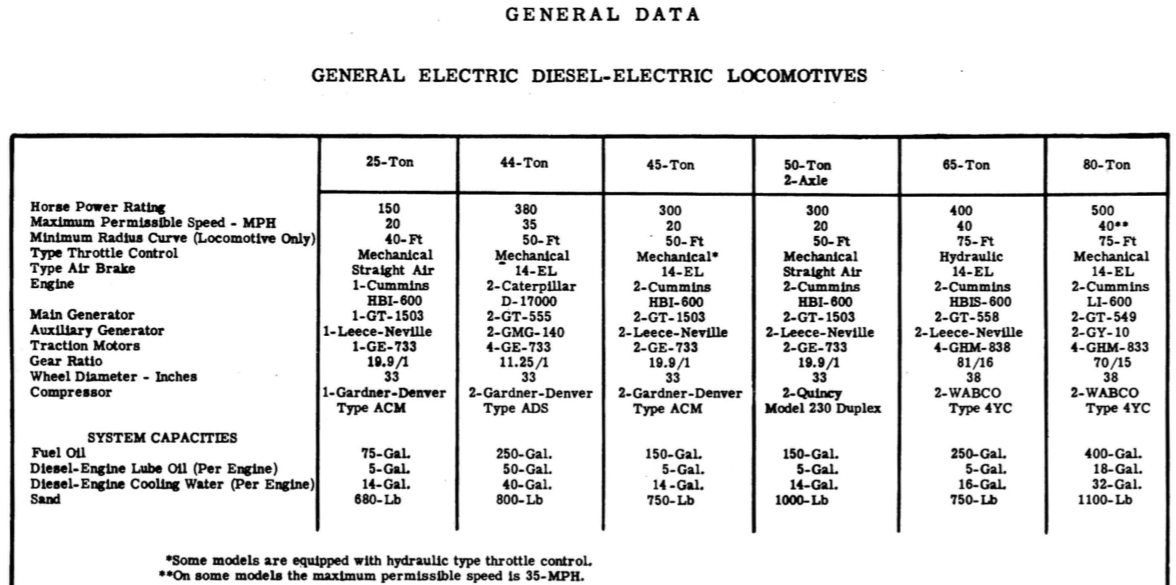

Thanks for the maintenance manual scans. 40 mph may be a problem for light engine move on Class One road mainline which is why I asked.
