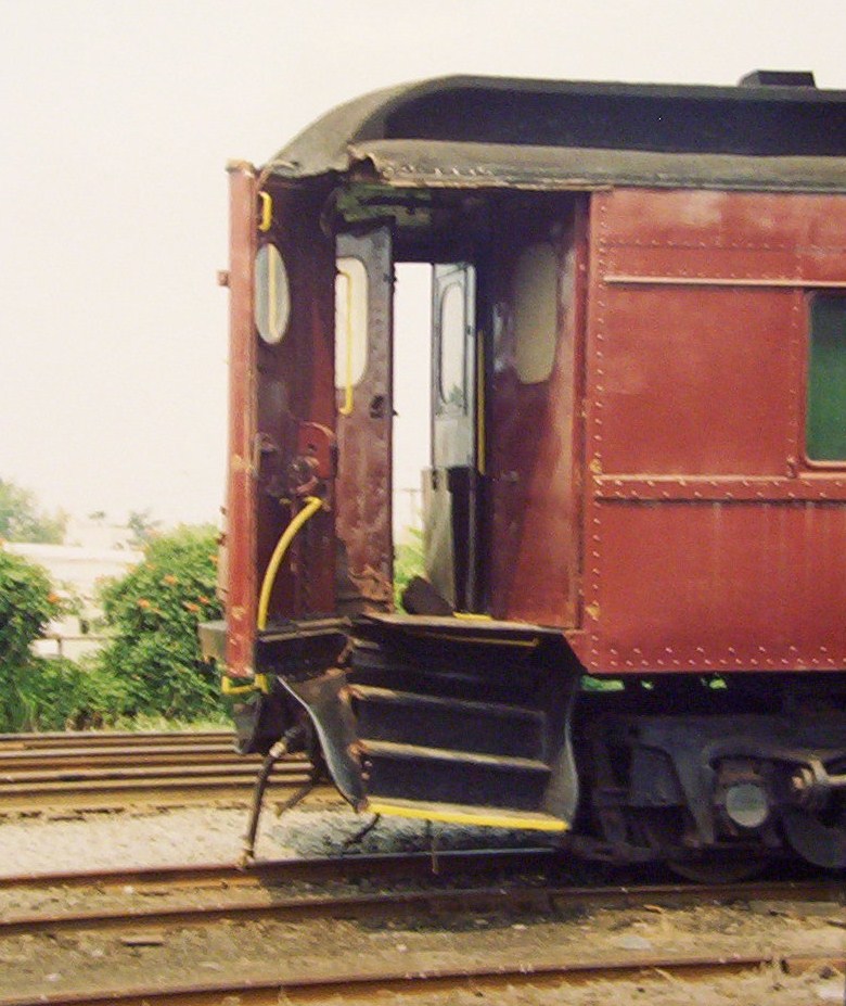

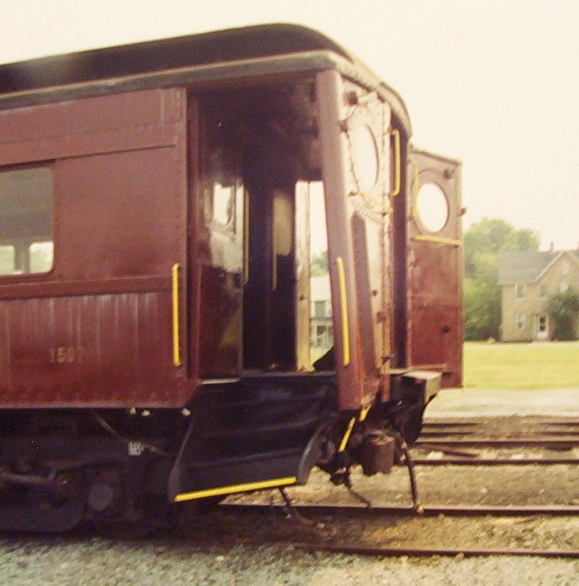

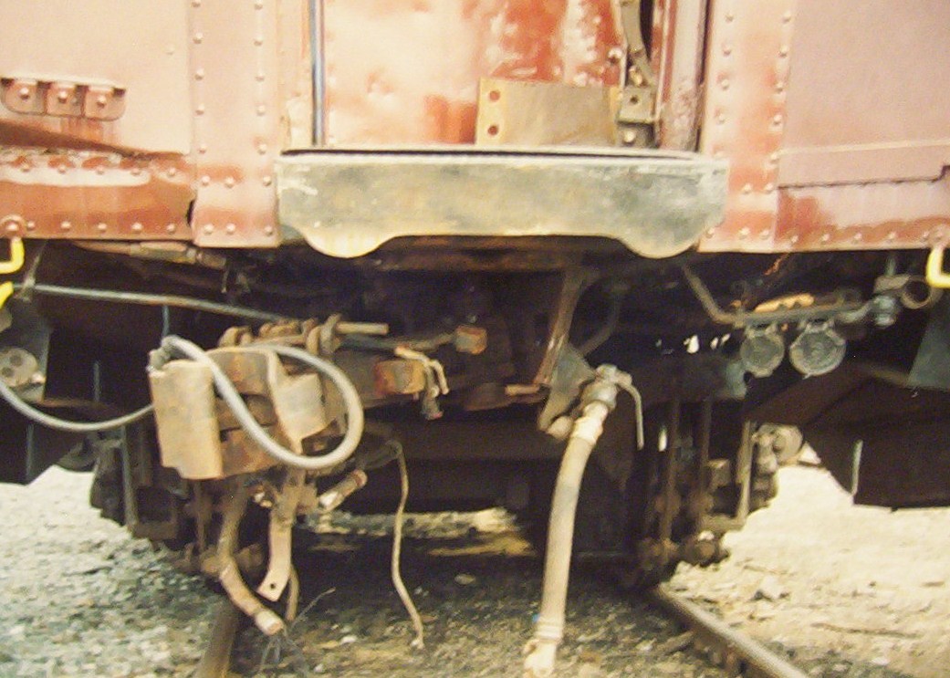

My stint as GM of Queen Anne's RR 1992-1997 is enough to know that it is a challenge to compete with the beach. Folks come to that area for the beach, and everything else is secondary. That secondary market is flooded with everything from miniature golf to seafood restaurants. Getting people to board an antique train to watch trees go past their windows is a daunting task, and expensive advertising. The OCRR didn't survive, and neither did QARR. Maybe there is a pattern? This proposal is in an area that is less populated with tourists than these past RR's and is more of a "transient" area, meaning people are going from Baltimore / Washington area to the beach and vice versa.
That said, I'll entertain you with some photos. The MDDE wanted our excursion consist for a special event weekend in Hurlock, MD, and we agreed. Bad decision. While the MDDE were excellent folks to deal with, Conrail was not. The cars had to be interchanged through Conrail to get to their destination, and on the return move, they didn't fare well in the middle of the night. I had a friend that was a Conrail engineer tell me the details, which Conrail management would not (they would not even meet with me nor my bosses). The cars were put on the end of an loaded coal train parked in the Harrington, DE yard. In the middle of the night, another section of loaded coal train with multiple locos (mucho horsepower) was backed into the parked section to make a full size coal train to go to the power plant the next morning. The backing was done blind with no one on the rear, and the coupling was made at about 5mph. When the move coupled, the crew assumed that they had coupled to the parked coal train, and as per their usual procedure, throttle up to shove the whole mess further into the track.
What they didn't know was that there were three antique passenger cars between two loaded coal trains. The ex-PRR MP54 blew out it's coupler pocket and jumped off the track sideways and sideswiped a tank car and covered hopper, which resulted in the end being pulled nearly off the passenger car. The other two passenger cars (N&W combine & NYC heavyweight coach) were OK. The cars were eventually delivered back to QARR, and the local crew informally relayed the message "keep your stupid old cars off our railroad".
We fixed the car, with new coupler pocket, draft gear, and coupler head. We straightened out and remounted all the bent metal, and dabbed on some paint. The car did fine until put out to pasture when QARR ceased operations, and has since been scrapped.

Oh my goodness. I had heard about this incident, but never seen the aftermath.
Brother Jordan's story all too graphically demonstrates why you DON'T send vintage railroad equipment out on Class Ones without an "escort," or "expediter." Even if you know the folks you think you're dealing with on a first-name basis. Conrail, at the time, was supposed to be one of the "better" railroads for knowing how to handle such things.
In my relatively few runs as expediter, I have personally witnessed appalling demonstrations of lack of common sense and clear thinking by employees whom I should have reported for potential firing for general incompetence, who seemed too dull or routine-bound to even be used as cannon fodder in the military. I've had shouting matches with crews in railroad yards at four in the morning (and had bottom-rung personnel act more competently than their supervisors). I've watched damage to car ends occur before my eyes, and documented them for the owner's sake. And I have heard tales of cars going the wrong compass direction on a railroad they weren't even supposed to be on in the first place.
You have to accompany the equipment with ALL the special instructions in your hands, and personally beat them about the head repeatedly with that stack of paper, and maybe other blunt objects: "IT... GOES... ON.. THE... END... OF... THE... FREAKING... TRAIN..... G*D... DAMM... IT!!!!! AND... YOU... DO... NOT... SEND... IT... OVER... THE..... FREAKING.... HUMP!!!! GOT IT?!?!?!?! REPEAT AFTER ME............"
