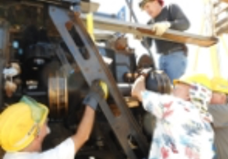

Photos posted recently by the Santa Fe 2926 restoration team in Albuquerque show her
piston valves being reinstalled after many years. This is a major step towards getting her moving under her own power again. See the installation process here

They just posted photos from 9/7 showing work on preparing the drifting valves for installation. Looks like installing those buggers can be exciting.

Right! Lots of potential energy that wants to become kinetic if not properly managed and contained!

The latest batch of photos from Albuquerque (9/14). Can't wait to see them try to install the drifting valve spring. Looks like trying to cram a 12 foot slinky into a 4 foot tube.

Yes, but remember that as the caps indicate there is only about 110lb. pressure on one end with the spring 'loaded' -- the point of the long multiple-turn construction is to assure that the spring pressure changes only negligibly when the ends move. Note that the two 'halves' of the spring are wound opposite so there is no winding up end to end.
It looks in a couple of those shots that they were thinking about gagging the spring with clothesline and presumably cutting it once the covers are on -- but that trick wouldn't be easy with the piston valves in, would it?
It'll be interesting to see how well these perform in the general service likely for this engine when finished.
