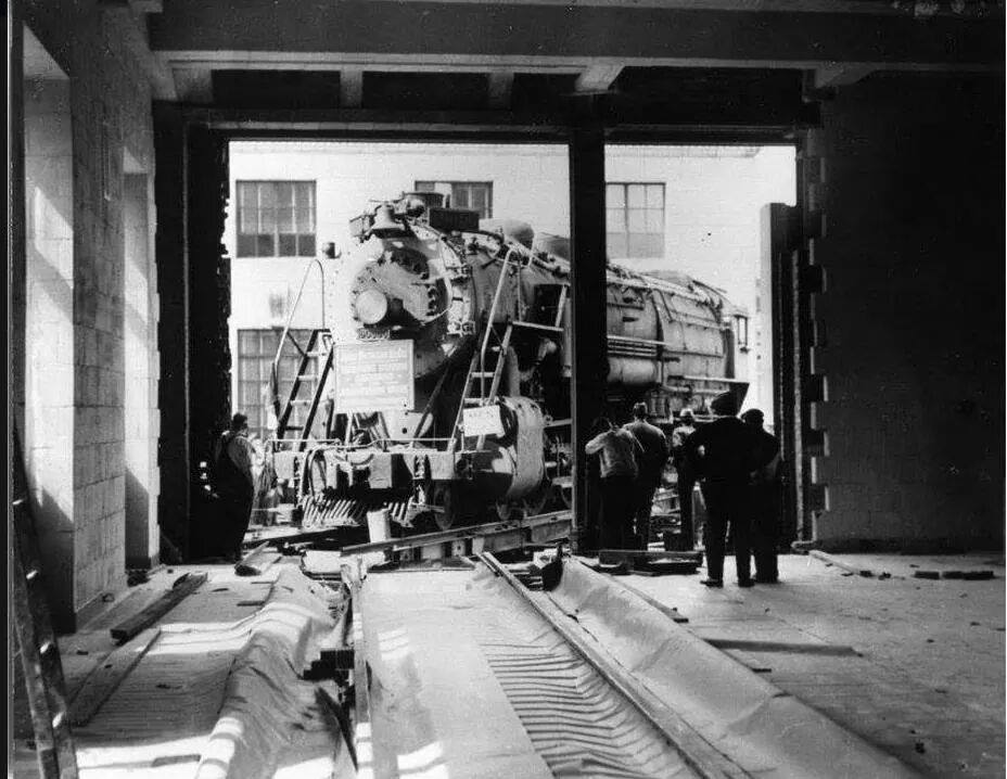

Our 140,000 pound locomotive required turning after delivery because the only large door on the "Engine House" was on the side. (This has since been remedied). It was delivered at about a 45 degree angle to the building onto a track panel with steel ties. A piece of heavy equipment was connected to each end with chains, one through the large door and one through a man door on the opposite side. After coating the floor under the ties with dish-washing liquid and water it came around nicely.
Apparently, no one got a photo of the turning, but this photo shows it going into the building.

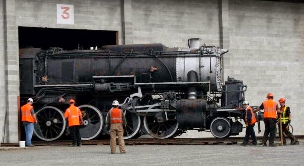

Old school turning of locomotive BLW 60000 to get it to line up with display track in the Franklin Institute.
