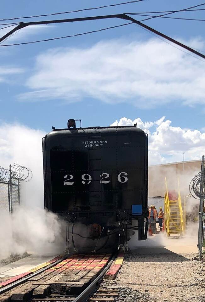

She’s hot this morning...

Are her pistons in?
Okay, on the rear of 2926's tender, I get that 7170 G.O. means 7,170 Gallons of Oil and that 24500 G.W. means 24,500 Gallons of Water. But, what does S.858 signify?

2926 finally sounded her voice under steam for the first time in over 60 years, a momentous occasion for those who have spent years working on her waiting for this
moment. You can hear it here
https://www.instagram.com/p/B0mxT-UHu6e ... hare_sheet
I know her pistons are not in yet, but should be soon. I will try to find out what the number means on the back of the tender for you

"But, what does S.858 signify?"
Flue sand capacity?
