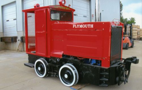

Orrville Railroad Heritage Society is looking into acquiring a Plymouth DL. Does anyone have any idea where to look for a construction number so we can trace its history? IIRC, the builders plates would have been on the lower cab side corners - they're long gone.
Thanks in advance for any tips.

The most common place for the PLW plate on locos of this model was inside the cab, either on the front or rear wall above the windows. PLW very seldom put plates on the exterior of their locos, almost always inside the cab. Being just a 3x5" piece of thin sheet metal it can be overlooked if covered with some layers of paint. Plymouths with a cast frame were not marked with the b/n externally but those with a welded frame almost always had the b/n stamped above the rear coupler pocket, either on the rear facing surface or on the top edge of the rear frame plate. This will be a 4 digit number, anything with fewer or more digits or letters included.may be a manufacturing code.

Thanks David. We'll have one of the guys take another look in the cab. I was busy inspecting it mechanically and didn't think to look at the time. It had, in automotive parlance, a recent frame-off restoration so if the plate was there before that, it should be back in place.

No builders plates that we can find. What little history I can find was that it was at Lake Erie Rail Car in New London, OH in the early '90s, wound up with the W&LE when they purchased LERC's assets and was then sold to the late Bob Bixler in Orrville, OH. Rumor has it that it was somewhere in Cleveland for about 10 years prior to LERC. There are also claims that it was built in the '30s.
If my memory serves, it has a Detroit/GM 371 in it. No clue what it was manufactured with. It is an 8-ton DL.

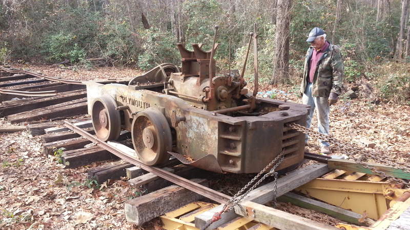

I have a 10 ton DLB, 1929. Brass plate was bolted to the front wall, above the 'fireman' window frame just below the roof.
The Buda engine was long gone when I got it. I have all the sheet metal and even still has the wheel shields. I haven't had a chance to really work on it yet, but the repower is going to be interesting. Any part numbers/pics of the engine to transmission setup would be most appreciated!

Hey John,
Thanks for looking up the info, but I meant it was build in 1929. I don't recall the serial number and the plate is packed away in storage. I didn't think about getting any information using the serial number!
Eric,
That would be great. I would love to get seriously started on it early next year.
Supposedly it was used at the Navy munitions plant in Charleston, SC. It was found behind a mobile home dealer in the woods. I bought it from the gentleman that rescued it.
